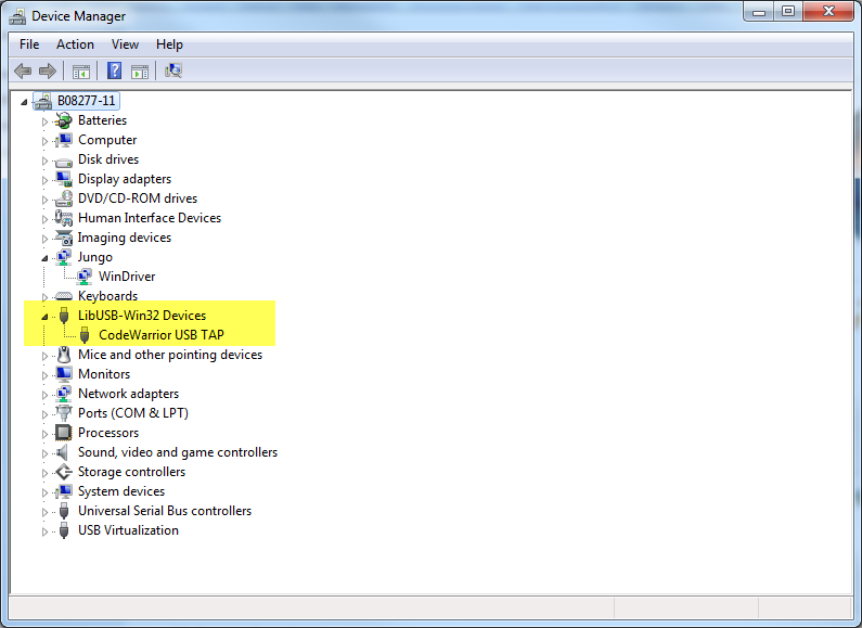

first please check device manager if USB tap is well recognized. This is the screenshot from my side.

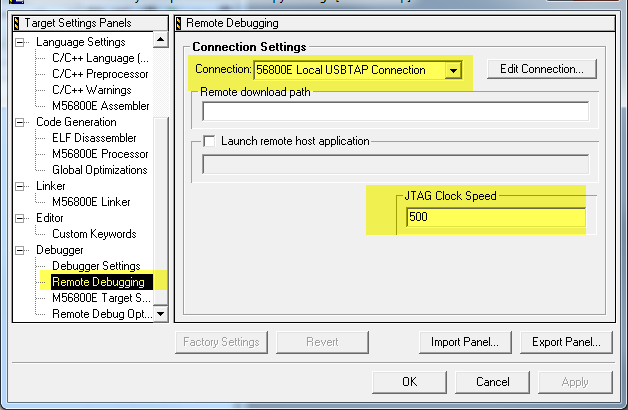

if you use customized board, please create a new stationery project for your board by doing New -> DSP56800x EABI Stationery -> Your Board(56F803) -> Simple C and Assembly.  Then change the Connection Settings to USB Tap and set the JTAG Clock Speed into 500.
