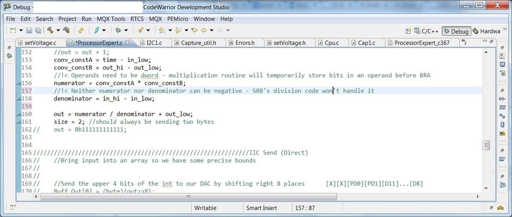

Found out my issue(s) on this -
For resolved breakpoints being ignored, I had to remove all breakpoints, right click on the project and hit "clean project", which essentially builds from scratch.
For un-resolved breakpoints, I simply had to reduce the number of breakpoints.
As far as the code running off into the weeds, this turned out to be a stack issue. I noticed that just before the function call it was pushing data onto the stack, which was running over my I2C variables and tricking the subroutine to think the bus was not ready. Increasing the stack size let the code run as designed.

gearhead1107
Looking further into this, it looks more like my issue isn't necessarily the processor starting at a random place, but (resolved!) breakpoints being ignored.
Shown below - the small section of code is causing the uC to just loop and not respond. However, the processor won't even touch those breakpoints (even though they show resolved) for me to step in and see what's going on. Is this a known issue?
Does anyone have any info on this? Or should I re-post in the CodeWarrior section?
