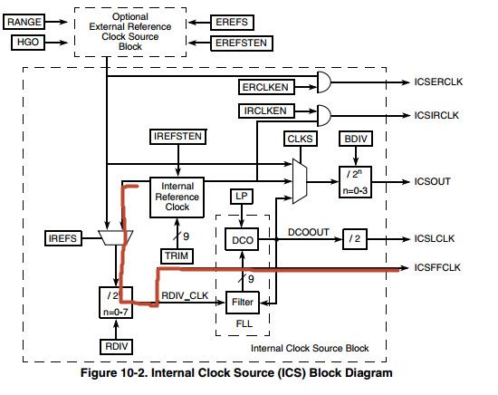

Here is my Understanding of ICS  Fixed  Frequency Clock ( ICSFFCLK)
Actually ICSFFCLK is not 15625 Hz as you mentioned in your code.
31250 Hz (Internal Reference clock) X 512(FLL) = 16000000 Hz= 16MHz / 2 (Default)= 8Mhz
8Mhz / 8 (Bdiv) = 1Mhz
So the ICSFFCLK is 1Mhz and Not 15625 Hz.My point is ICSFFCLK is not coming directly from Internal reference source , instant of that after FLL.
Hope this will help you.
For reference of ICSFFCLK please see in Attachment AN3041.
Robin

weapon
Senior Contributor I
Hi Maria,
As your setting, ICSFFCLK(Fixed clock freq) is 31.25KHz, I attached one picture to show you the clock path of ICSFFCLK, which is the divieded FLL reference clock.  please try to double your modulo of MTIM.
B.R
Weiping

The ICS provides the divided FLL reference clock as ICSFFCLK for use as an additional clock source for
peripheral modules. The ICS provides an output signal (ICSFFE) which indicates when the ICS is
providing ICSOUT frequencies four times or greater than the divided FLL reference clock (ICSFFCLK).
In FLL engaged mode (FEI and FEE), this is always true and ICSFFE is always high. In ICS Bypass
modes, ICSFFE will get asserted for the following combinations of BDIV and RDIV values:
   BDIV=00 (divide by 1), RDIV ≥ 010
• BDIV=01 (divide by 2), RDIV ≥ 011
• BDIV=10 (divide by 4), RDIV ≥ 100
• BDIV=11 (divide by 8), RDIV ≥ 101
17,198 Views
marmor
Hi Weiping Xu.
I changed the module as you said and does not work properly. Before, the for loop with the delay1s () function inside should produce a delay of one minute but produces a delay of 6 seconds or less and changing the value to the double produces a delay of 12 seconds or less.
I do not understand what could be wrong.
