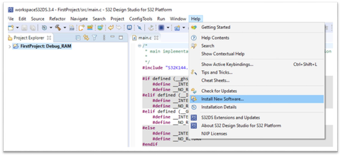

  • go to menu "Help" -> "Install New Software"

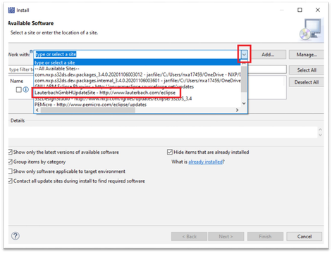

  • Click on the arrow to bring up the list.
Select ‘LauterbachGmbHUpdateSite - http://www.lauterbach.com/eclipse

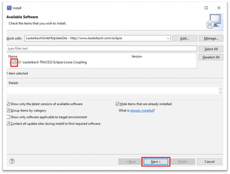

  • Check the box next to the Lauterbach TRACE32 Eclipse Loose Coupling and click "Next"
  • Check "I Accept the terms of the license agreement" and Select all Lauterbach certificates to trust.

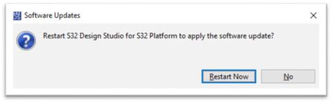

  • Finally you proceed to the installation. When the plugin is installed you will be asked to restart S32DS

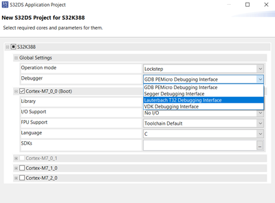

Now you should be able to use the New Project Wizard create an application project with Lauterbach Debugger support:

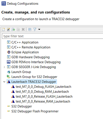

Or manage (create, delete, adjust) Lauterbach eclipse debug configurations:
