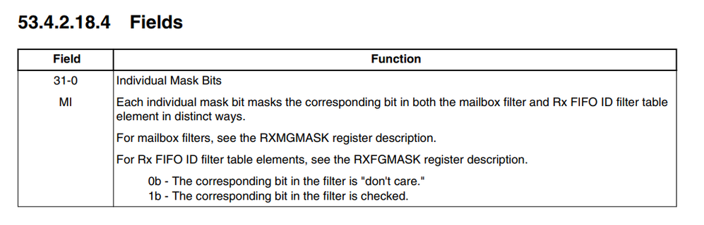

The MB works the following way:
FLEXCAN_DRV_ConfigRxMb, this function configure the mailbox and the receiving ID, so only the messages send to this ID will be received.
FLEXCAN_DRV_SetRxIndividualMask, this function sets the RX mask, this mask corresponds to the following description:
So, only the bits sets are checked, for example, if you set this to 0 all the messages will be received, and depending of the bits set, the corresponding bits will be ignored of the ID.
An example, if you set the configuration like this:
    can_buff_config_t buffCfg =  {
        .enableFD = true,
        .enableBRS = true,
        .fdPadding = 0U,
        .idType = CAN_MSG_ID_EXT,
        .isRemote = false
CAN_ConfigRxBuff(&can_pal1_instance, RX_MAILBOX, &buffCfg, 2);
CAN_SetRxFilter(&can_pal1_instance, CAN_MSG_ID_EXT, RX_MAILBOX, 0xFFFFFFFE);‍‍‍‍‍‍‍‍‍‍‍‍‍‍‍‍‍‍‍‍‍‍‍‍‍‍‍‍‍‍‍‍‍‍‍‍‍‍
The mailbox will receive the ID 0x2 and 0x3.
Also, the TX Mailbox and RX should be different.
