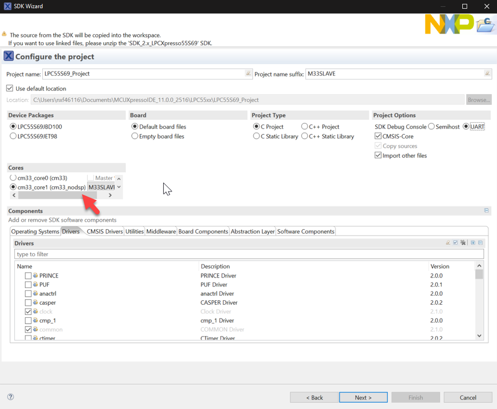

First you will need to create the SLAVE Project. In the Quickstart Panel select the option New Project, select the SDK from the LPC5556x. In the next window select the option for Slave core:

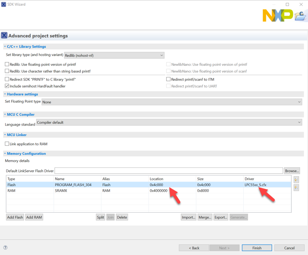

Press the next button and in the next window, split the flash memory and delete the first and third RAM section. Also in the driver for the flash controller select the LPC55xx_S.cfx. After that press the Finish button

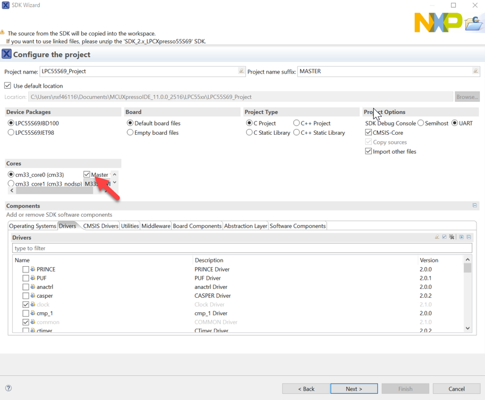

You'll need to create now the master core project. Follow the same process and in the next window select the option for master core:

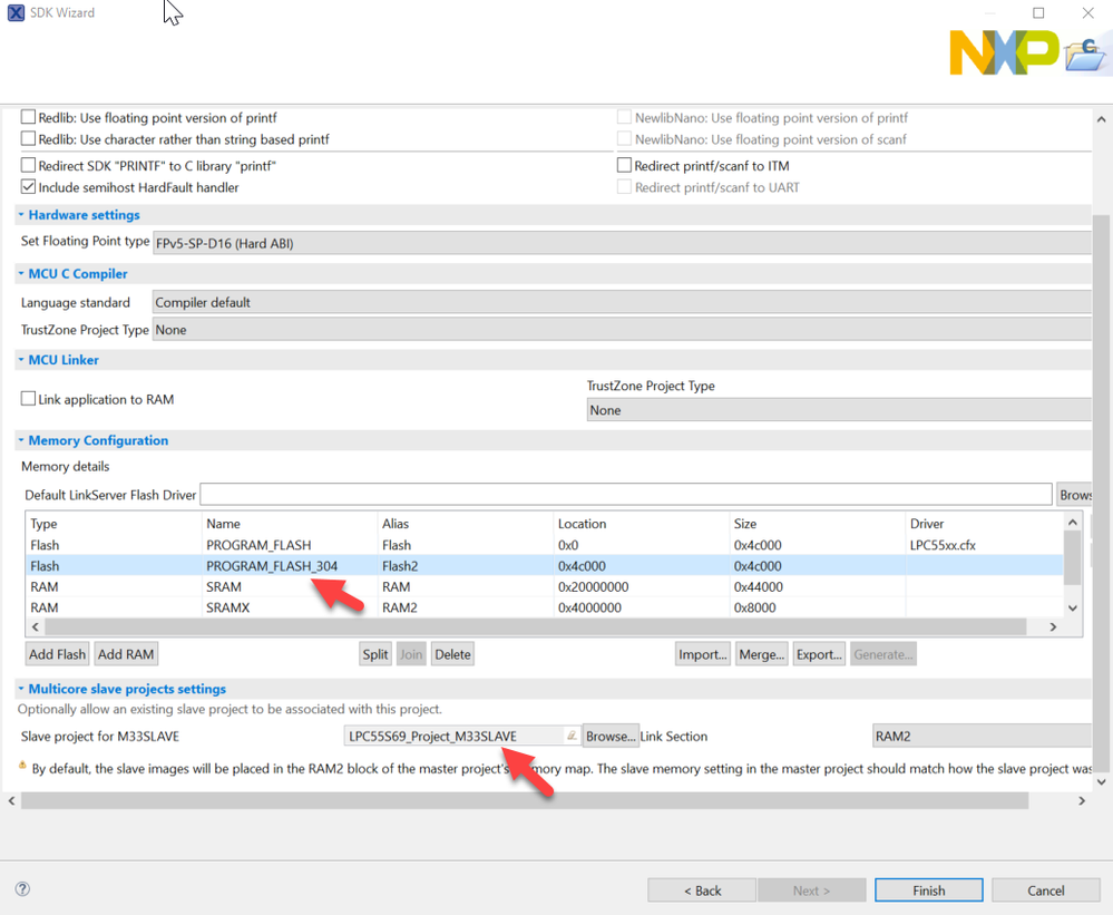

In the following window split the flash memory, and select in the Slave project for M33Slave the project you previously create. Doesn't matter the Link section since we'll change it. Also the driver leave it as it is. Press the finish button.

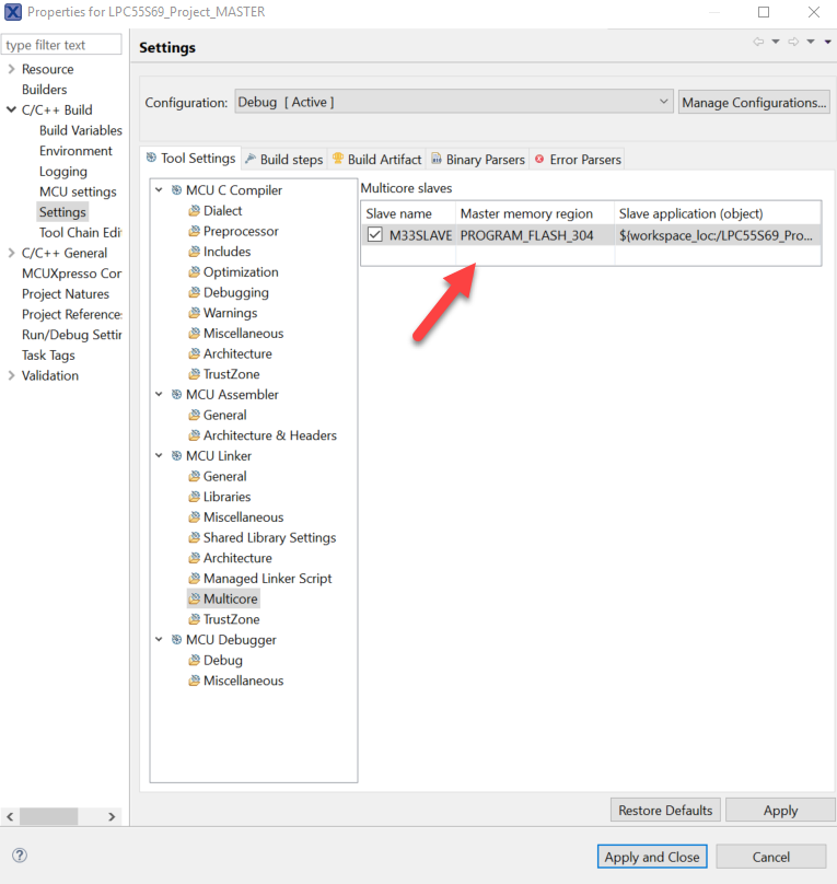

After that, we'll need to set the second flash section as the one used for the slave core. Access to the properties of the project -> C/C++ Build -> Settings ->MCU Linker -> Multicore and in the Master Memory select the second section of the flash.

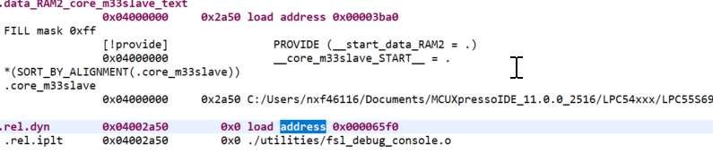

The image of the slave code is placed in RAM but the primary code will boot the secondary core and place the image in flash.
If you check the .map file you can see something like this that says where is loaded the slave core image.
