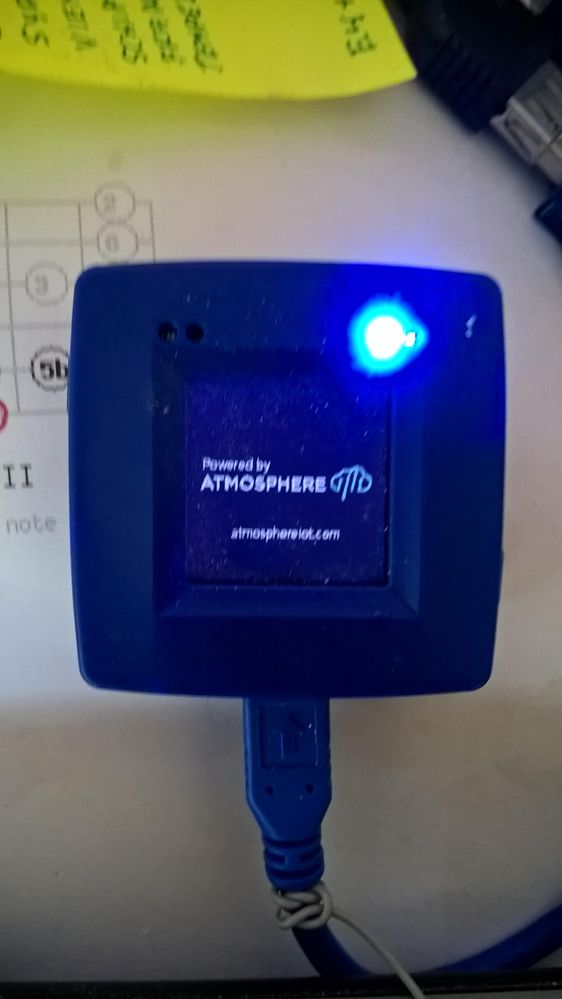

europevideo
My device is broken it starts until the Atmosphere screen then it stops with the blue LED continu on, no further activity.
-None of the resets helps
-New 'out of the box firmware.bin' does not help.
-Other .bin files from the NXP website will upload to the device but end in the same screen.
M 0060370000127D20
ID 410486749406069B
I know i was a early adapter but this lifetime is very short,
Any suggestions?
Greetings,
Hans Volbeda (Netherlands)
11,522 Views
europevideo
This problem is solved,
Reloaded the KW41Z bootloader by USB.
https://community.nxp.com/message/1151280?commentID=1151280#comment-1151280
