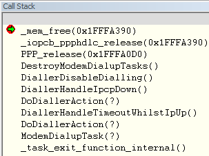

Our product uses a GPRS modem to send UDP data. When the modem sends us a disconnect we close the connection to the modem and then attempt to re-connect again. Every time the IP connection to the modem was established the software grabbed another 944B. The spare RAM we had could quickly disappear it eventually lost GPRS connectivity.
I turned on kernel logging and found 2 memory free calls that failed due to MQX_NOT_RESOURCE_OWNER in the task that makes the PPP connection.
Using break points I tracked the memory leak down to the PPP_init() PPP_release() functions.

Stepping through the PPP_release() function I tracked the MQX_NOT_RESOURCE_OWNER errors down to the following calls (note that the call stack shows a different build to the Memory Block Summary shown above):
The above two blocks that couldn’t be freed (twice) are the 208B and 608B blocks. The _mem_free() reckons that the ModemDialupTask (0x10013) doesn’t own the blocks, but the Memory Block Summary clearly states they are owned by 0x10013 and it is currently in that same task!

I could not work out why the _mem_free() kept failing with MQX_NOT_RESOURCE_OWNER as the current task did own the memory block, so I simply forced the memory allocation functions to use system memory instead and added the missing memory free in function PPP_release().
