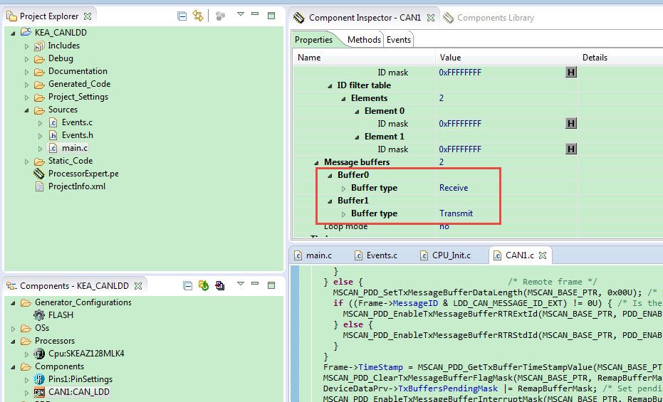

We have a PLC to work with a device using CAN2.0 protocol, now we intend to add a Freescale KEA128 into the existing system using its CAN interface to communicate with the PLC and possibly the other device. But we are not sure that we could correctly using the methods provided by KDS2.0 Processor Expert after adding the built-in CAN device. So please help with demo code fragment.

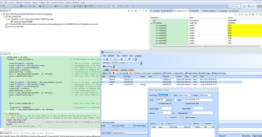

      I have a PE KDS3.0 KEA128 CAN project, please find it from the attachment.
      I test my project on our TRK-KEA128 board, it works ok,  following is the test result:
Wish it helps you!

I noticed that in Jingjing's code, BufferIdx=1 was passed to SendFrame(), and the loopback test failed when passing BufferIdx=0 into it, I don't know the reason why? Is it possible to elaborate it?

Hi Chao Dong,
    Because my project configure the transmit as the buffer, if you want to use the buffer0 as the transimt, you should configure it in the CAN_LDD:
Wish it helps you!

    I already test it on our TRK-KEA128 board, it  works ok on my side, and when I put break point in the CAN_OnFreeTxBuffer() or CAN_OnFullRxBuffer( ), these code can be entered, the according interrupt also can be entered.
    My test in connect the external CAN bus tool on the TRK-KEA128 board:
CANH and CANL.
If you have the TRK-KEA128 board, you can test it on your side.
