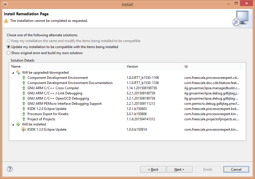

Is partial KDSK1.3 update in KDS300 safe?
5,941 Views
neilhancock
Wow found the candy store available with newly released KDSK1.3
So following the KSDK13GSUG.pdf
I downloaded "Kinetis SDK 1.3.0 Mainline - Windows.exe" and installed it 3GB
In section 5.2.1 I follow the instructions to Install Eclipse Update for KDS300
from directory  and though its not specified where in the instructions I found it here
C:\Freescale\KSDK_1.3.0\tools\eclipse_update
KSDK_1.3.0_Eclipse_Update.zip

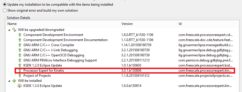

On attempting install it says
Cannot complete the install because one or more required items could not be found.
  Software being installed: KSDK 1.3.0 Eclipse Update 1.0.0.b150914 (com.freescale.processorexpert.kinetis-ksdk-1.3.0.sp.feature.group 1.0.0.b150914)
  Missing requirement: KSDK 1.3.0 Eclipse Update 1.0.0.b150914 (com.freescale.processorexpert.kinetis-ksdk-1.3.0.sp.feature.group 1.0.0.b150914)
requires 'com.freescale.processorexpert.feature.core.kpsdk.feature.group [1.3.0,2.0.0)' but it could not be found
and the Update my installation to be compatible ...
Does anybody know if its OK to accept a partial update like this.?
Is KSDK_1.3.0_Eclipse_Update.zip  an update for the PE components inside KDS300?

After reading this 'thread' I found my problem: The instructions to install a DYI Eclipse has  PEx_for_Kinetis_3.0.1.zip being installed AFTER installing  KSDK_1.3.0_Eclipse_Update.zip which in my case and many others will fail since PEx_for_Kinetis_3.0.1.zip has NOT been installed!
Those instructions need a few tweaks me thinks.

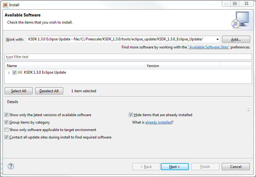

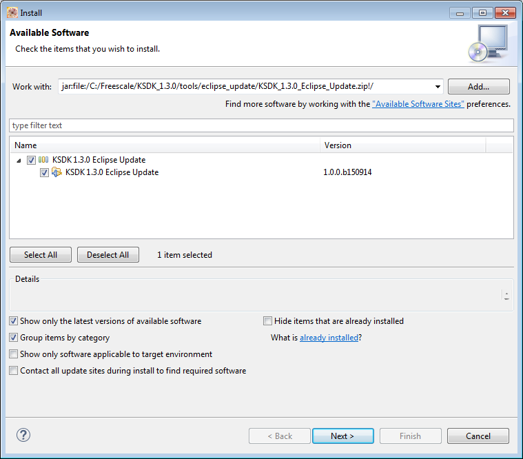

thomasolenik
Thanks everyone for taking the time to post help. I think there is one step missing from these instructions though. The 'KSDK_1.3.0.Eclipse_Update' folder is zipped. I had to extract that zip file first before KDS would even see it in the Available Software window. Once the file was extracted I was able to navigated one level lower in the Install Software window within KDS to:
C:/Freescale/KSDK_1.3.0/tools/eclipse_update/KSDK_1.3.0_Eclipse_Update/
instead of just:
Only then could I successfully install the KDS 1.3 eclipse update. Here is a screen shot:
I hope this helps someone.

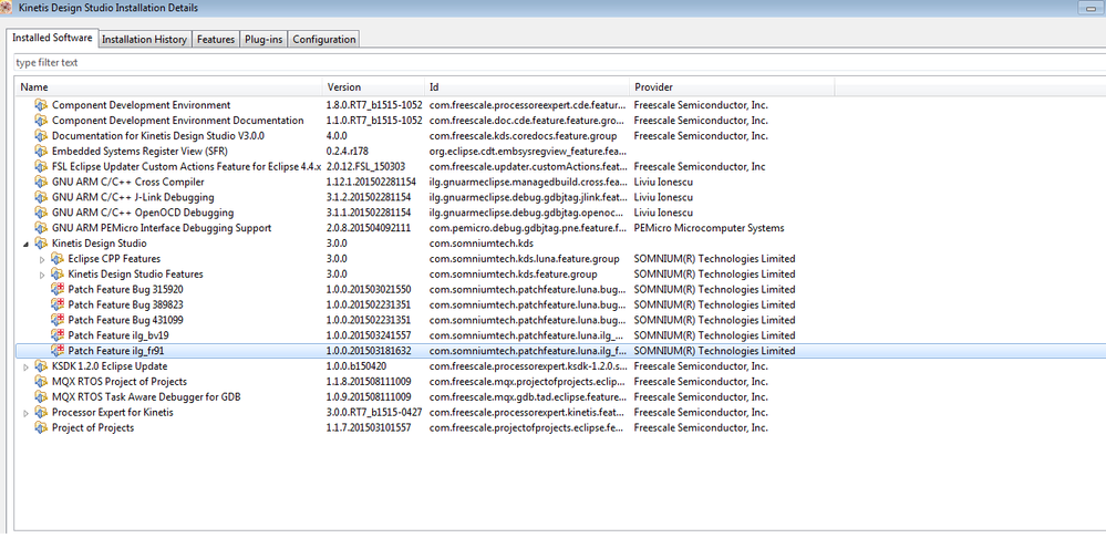

BlackNight
Hi Neil,
I had no such dialog installing it:
I believe it is because I had the updates already installed, and you probably not?
Note that I had the plugins patch file attached in Unable to Debug after KDS Update  installed too.
After doing the above update, I have not faced any issues with Segger J-Link, both with OpenSDA J-Link and J-Link hardware.
Here is what I have installed now:
I hope this helps,

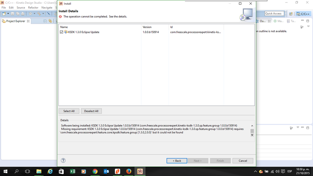

garylynch
My attempt at install ends in the exact same diagnostic as
Neil's:
but my version profile is somewhat different:
Can you tell from this what I have to upgrade/downgrade to
get my KSDK working? I am using Windows 7.

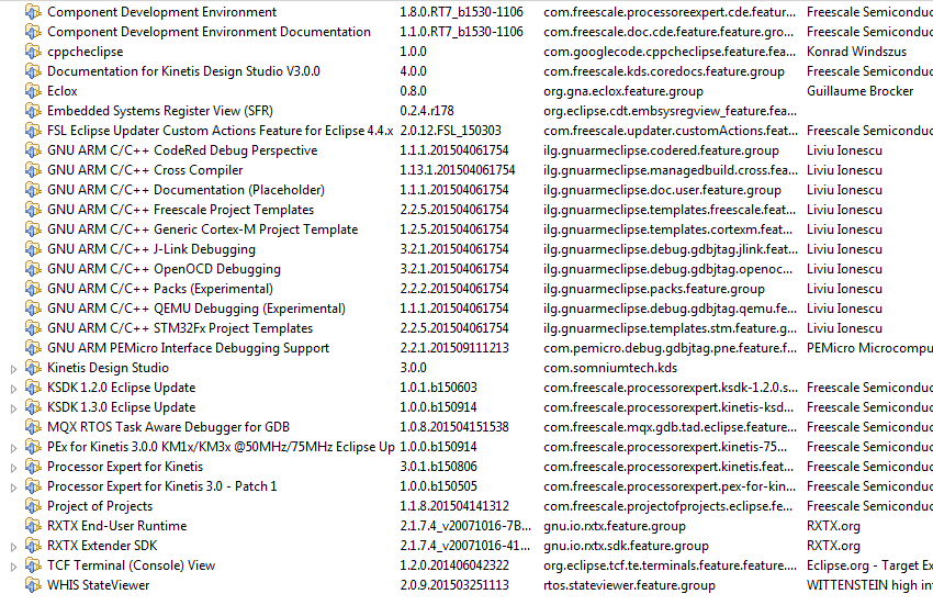

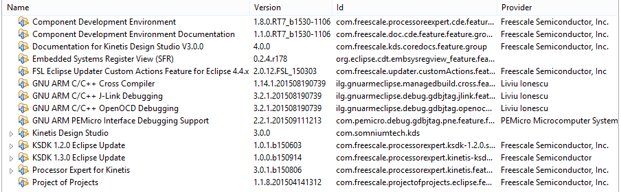

neilhancock
Hi Eric
Thanks for sharing the details and followed your suggestion. I've ended up with different versions of GNU xxx - possibly because you said you tried rolling back an update in your post.
With KDS300 I followed through with a Help-Check for Updates- installed everything
Then applied your Aug7th plugins in C:\freescale\kds_v3.0.0\eclipse\plugins
and then a KDS1.3.0 update  - Help -Install New Software - Add- Archives - C:\Freescale\KSDK_1.3.0\tools\eclipse_update\KSDK_1.3.0_Eclipse_Update.zip
I end up with this from Help-Installation Details
Do you see any issues with this.?
My next steps are trying some debugging on a Frdm-K64F/JTAG(multiLink) board so hope it doesn't press that security lock key. :smileyplain:
4,025 Views
BlackNight
I don't see any issues with what you show.
Debugging is working fine for me, and as said: that J-Link debugging issue was resolved with the patch.
I had no issues with securing devices at all as well earlier: the problem was that the j-link debugger did not start at all, so if you see device securing issue, I think that would be something different.
Erich
4,025 Views
neilhancock
many thanks - appreciate it - its worked for me. :smileyhappy:

vfilip
KDS 3.0.1 update must be installed prior to PEx for KSDK 1.3.0 otherwise this SP may not work correctly.

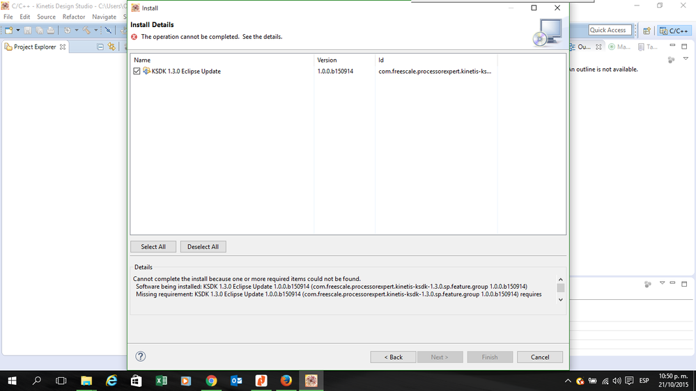

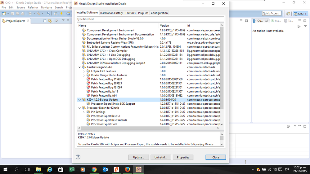

OROZO
I have same problem... I'm trying to install the KSDK 1.3.0.
And after a while...
details message:
  Missing requirement: KSDK 1.3.0 Eclipse Update 1.0.0.b150914 (com.freescale.processorexpert.kinetis-ksdk-1.3.0.sp.feature.group 1.0.0.b150914) requires 'com.freescale.processorexpert.feature.core.kpsdk.feature.group [1.3.0,2.0.0)' but it could not be found
I did replace the plugins like you said in your other post, but still I can't upgrade to KSDK 1.3.0.
Any helpful hint?
