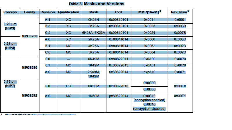

Also, new MPC8260A device have new functionality (PCI block), which should be properly terminated if not used. The following is said in application note AN2291:
7.2 HiP4 Silicon
The spare pins U5, V4, and AE11 (on PCI devices, AE11 is CLKIN2; refer to the "MPC82xx/MPC82xxA
Functionality" table on page 2) may be pulled down (recommended) or may be left floating. However, on
all HiP4 silicon (both PCI and non-PCI devices) when PCI is not used, note the following:
  AF25 must be pulled up or left floating

The package mark is MPC8260ACZUMHB(266/166/66Mhz),  PVR indicates Hip3 device, why?  The ordering information indicates that "A"  is Hip4 device.
On my board, the spare pins U5, V4, and AE11 (on PCI devices, AE11 is CLKIN2) is grouded.
and the AF25(PCI_MODE#) pin is pulled up.
"new MPC8260A device have new functionality (PCI block)" , which revision?  Is MPC8260A(Hip4) devices?
I know only MPC8266,MPC8255,MPC8250 (these 3 devices) include PCI block,
Both MPC8260(Hip3) and MPC8260A(Hip4) don't include PCI block. Right?
In AN2291 , Mark and Revision, the table lists different chip revisions. the "Quailification" coloumn is "XC" or "MC", what is the meanings?
I try to modify the clock setting on board which can boot successfully(CPU is MPC8260ACZUMHB-266/166/66Mhz,0.29um Rev C.2),
the orginal setting is 200/133/66(MODCK_H=0101,MODCK=111), MF = 2, XFC pin capacitor 1500pF, according to AN2291( Hip3/Hip4 clock settings,  MF*750-90=<XFC <= MF*840-90)
now I change to 200/166/66((MODCK_H=0110,MODCK=101), MF = 5 , XFC pin capacitor 3700pF, but  CPU can't boot,
I use USB-TAP to check it,  the programm jumps to 0x700 address(programm error), why ?
And I change to original clock setting and XFC capacitor, CPU boot succesffuly.

alexander_yakov
If the package marking shows Hip4, but reading PVR register indicates Hip3 than I suspect this is a counterfeit product.
We are aware about counterfeit Freescale products, please read the following document:
http://cache.freescale.com/files/shared/doc/pcn/PCN11824.htm
