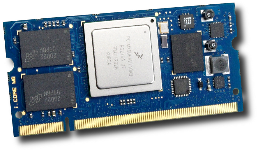

Dimensions - Standard SODIMM footprint 67,4x31.9 mm PCB size
- Very Low Profile Module
| ![M6Q.png M6Q.png](/t5/image/serverpage/image-id/21911iC3BA8BC7F1C8D368/image-size/large?v=v2&px=999)
