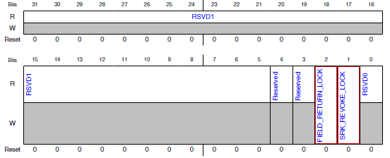

Users can check OTP Controller Sticky Bit Register (0x410a6050) from U-Boot terminal to confirm SRK Revoke and/or Field Return fuses are locked:
Fig 1.  OTP Controller Sticky Bit Register
=> md 0x410a6050 1
410a6050: 0000001e
