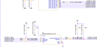

We have a board that has Micron QSPI (MT25Q group) on FlexSPI 2, Secondary Pin Group. The QSPI is routed to these pins:
  • FLEXSPI2_A_SS0_B
  • FLEXSPI2_A_SCLK
  • FLEXSPI2_A_DATA0
  • FLEXSPI2_A_DATA1
  • FLEXSPI2_A_DATA2
  • FLEXSPI2_A_DATA3

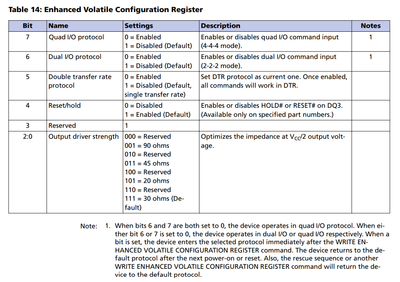

I have tried setting the Quad I/O enable bit (bit 7) in the Volatile Configuration register of the Micron device, the register you listed. Since this is Volatile I need to do this in a LUT in the Flash Configuration block as it needs to be set in every bootup. This did not seem to help.
I've also set the Quad I/O Enable bit in the Non-Volatile configuration register of the Micron device (0xB1). I've confirmed that this value persists during power cycles. This is similar to what the flash loader does by setting the Non-Volatile QE bit in the Status register of the ISSI device. This however also doesn't seem to allow the device to boot from flash.

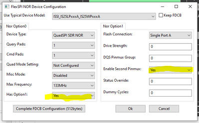

Can you try to flash the board with the MCUBootUtility tool? The tool can generate proper FDCB automatically. Let me know the results.
Victor

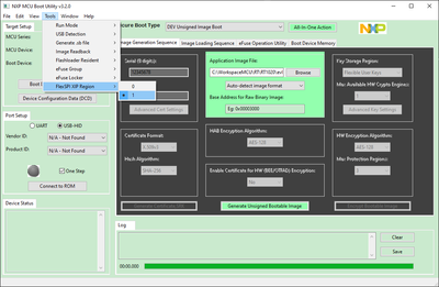

Thanks for your patience with this thread. When using the MCUBootUtiliy, if you go to the Tools menu, you'll find an option named FlexSPI XIP Region. This option is to select the FlexSPI interface from which you want to boot. To select FlexSPI2, you need to select the 1.
Are you able to get this working if you select this option?
Victor
