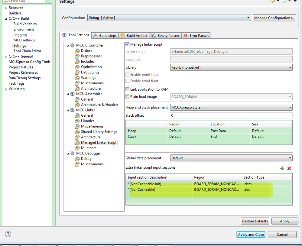

i tried to use sdram in the "evkbimxrt1050_dev_hid_generic_freertos" project,i configed the project as the attaches。 my PC can not find the HID device while debugging ,can anybody tell me how to config the project correctly?

by open  the SDRAM_IS_SHAREABLE ,it works。

kerryzhou
Hi Steven Zhang,
    If you are using the USB with SDRAM, you need to configure the USB buffer to the nonCacheable area.
   So you also need to add the below configuration in your project:
  Another simple way, you also can try to disable the cache, comment the cache:
    SCB_EnableDCache();
    SCB_EnableICache();
In board.c BOARD_ConfigMPU().
You can try it on your side.
If you still have questions, please kindly let me know.
Kerry

kerryzhou
Hi Steven Zhang,
  That's very good to hear it works.
   Shareable means non-cacheable by default.
