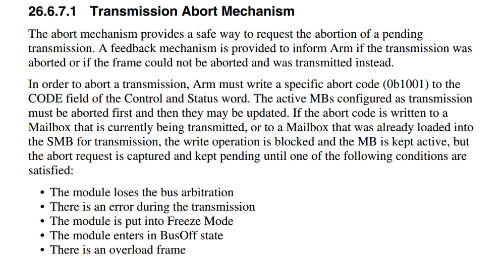

CAN protocol has a function about auto retransmission, When that failed to be transmitted is sent again. So, When I don't want to this function how to close in RT1052. Additionally, FlexCAN can abort transmission when there is an error during the transmission, and can you give me a reference example for it?
Looking forward to your answer.

Hope you are doing well. You are correct, single transmission is not supported by the FlexCan module.

It is only possible to abort regular transmission, there is not a single transmission supported in this flexcan module. At the moment there is not an example that uses the abort transmission, however the drivers include this CODE so that customers can implement this in their application faster.
Please refer to the fsl_flexcan driver and the FlexCAN chapter in the reference manual for more details on how to use the abort transmission CODE.
