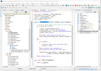

Thank you for the reply. I found the example in the SDK and have loaded it into my workspace. I will start experimenting with it soon.
I'm trying to use the camorra module in code that I'm designing and this will help me to learn how the hardware for the camera is controlled.
At first glance into the code, it looks as if all the interfacing is done in the source\image folder?
Specifically in \source\image\image_capture.c ?
