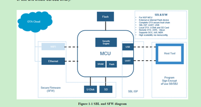

Please check the follow information from the FOTA:
You can see, in the SBL, it supports the ISP(UART/USB HID), you can use ISP UART to download code. If you want to use SD card, you need to use SBL+SFW.
You can consider, SBL is the secondary secure bootloader, and SFW is the firmware which also contains the special download interface, eg, SD card, ethernet etc.
You can use the sd card to install the image, it's OK. you mentioned USB cdc, in fact, it is the UART ISP, the SBL can use the UART download the SFW directly, but your SBL you need to program it with debugger or enter serial download mode to download it.

   The FOTA is published, please check the following link:
Secure Bootloader(SBL) :
https://github.com/NXPmicro/sbl
Secure Firmware(SFW) :
https://github.com/NXPmicro/sfw
Please download the link code in the github, if you meet any issues, just kindly let me know.

Thank you for letting me know about the SBL and SFW projects.  A lot of work has been done. How do you envision we use SBL and/or SFW for our specific application?  Our RT1176 application will be communicating with a Linux PC (industrial single-board-computer) over USB with RT1176's USB1 configured in communication-device-class (CDC) mode.  We will have the QSPI Flash (16Mbyte NOR U23 on RT1170-EVK) on the board, but had planned on using the SD Card for main firmware storage and execute from SDRAM for maximum performance. I looked through SBL source code and it appears to reside in the QSPI NOR flash, but also stores the update firmware image to the QSPI flash - so we wouldn't be able to use the SD Card for the main firmware image?
The SFW is for OTA updates from ethernet, SD-Card, or a USB Flash Drive. Are you thinking we should modify SFW to receive the update over CDC USB?
It appears that neither SBL or SFW are available as an MCUXpresso project. Is this correct?

   In fact, the SFW is the example for the customer, customer also can modify it by their own demand, eg, if you want to boot from sdcard, then run in internal SDRAM, you totally can copy the code to the SDRAM, and jump to the related address to run it, as i know, the SBL already help you initialize the SEMC, so you can use the SDRAM directly.
