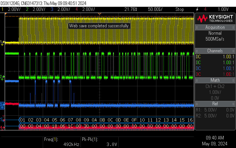

Using two MIMXRT1170-EVKB running MIMXRT1170-EVKB-lpspi_edma_b2b_transfer_master_cm7 in one and MIMXRT1170-EVKB-lpspi_edma_b2b_transfer_slave_cm7 running in the other. These examples running on IAR are just supposed to mirror the master's data back from the slave. The connections are below:

The SPI signals show little to no communication back from the slave.
Is there some other troubleshooting that we might be missed?

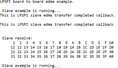

  1. Repeated the initial test with the MIMXRT1170-EVKB boards and the slave board terminal displayed junk every time.
  2. Swapped the MIMXRT1170-EVKB board programs and the slave board displayed junk again every time.

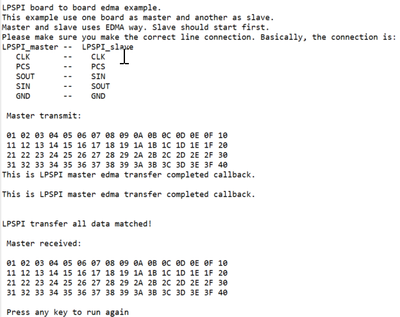

I test the same example using two MIMXRT1170-EVKB and it works for me.
I see that you follow the hardware requirements (from readme file) removing the 0Ω resistors R200, R404, R406, R2016, R2097.
Could you please help me trying again but swapping the master and slave? This in order to see if your slave board is damage.

  • Tried LPSPI DMA SPI with MCUXpresso and SDK 2.15.100, reversed the boards, same result junk data is read
  • Tried LPSPI Interrupt SPI with MCUXpresso and SDK 2.15.100, reversed the boards, same result junk data is read

I think the issue is tied to length of GND wire between the two boards. A shorter GND wire was used between the original two GND point connections and the example worked. Knowing SPI is usually considered "low speed" communications, what is the difference between LPSPI, SPI, and Flexcomm SPI that might show this issue?

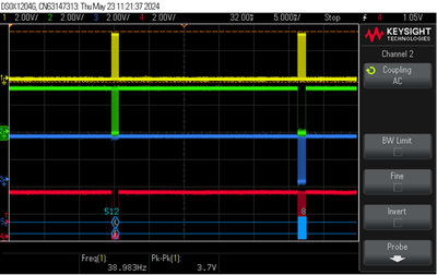

My customer moved the GND connection between the two boards from TP39/TP27 to a different GND point (J10.14). This seemed to clear up the issue and now he has MOSI/MISO communication between the two boards as expected. I took a look at the layout .pdfs and could find no real differences between the TP and the header GND. What do you make of this?

What we know is that test points are for evaluations proposes and they are not the best for field applications. But give me more time to consult with my team.
