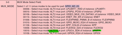

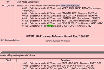

EDIT 1:
As it tuned out, fsl_iomuxc.h generates slightly different configuration for I2C4 depending on what pins it is defined.
The code snippet below is for the configuration that does not work, and on the 4th position we can see 0x01 value there. It is responsible for setting the inputDaisy pin configuration.
#define IOMUXC_GPIO_DISP_B2_12_LPI2C4_SCL 0x400E8244U, 0x6U, 0x400E85C4U, 0x1U, 0x400E8488U
Whereas for the configuration that was set on different pins (the ones that I2C4 actually works) it looks like this:
#define IOMUXC_GPIO_AD_25_LPI2C4_SDA 0x400E8170U, 0x9U, 0x400E85C8U, 0x0U, 0x400E83B4U
After changing that inputDaisy value for the not working configuration, I got some clocking action on the SCK pin, but unfortunately still no data on the SDA pin

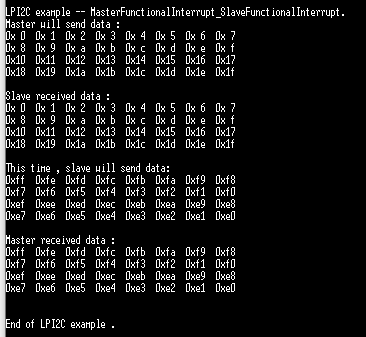

Pavel_Hernandez
Hello, this test was done in the EVKC. Both I2C3 and I2C4 can work normally.
I2C3 pin: GPIO_DISP_B2_10 and GPIO_DISP_B2_11.
I2C4 pin: GPIO_DISP_B2_12 and GPIO_DISP_B2_13.
I do some rework on board, SDK version is 2_15_0.
Picture attached below shows the log of test demo:
I attached test project, pin configuration can be check in project, I2C b2b test also done and can work normal.
Place grey out in config tool is because of the difference of pad. DISP_GPIO_DISP_B2 and DISP_GPIO_DISP_B1 are different pad and the control of them is different too.
Pavel

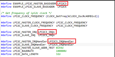

mimlo
Hello @Pavel_Hernandez,
I downloaded your example and what I saw was that you are using I2C5 and I2C1 in the example. I also do not see the pins I mentioned I had problems with being used. Is this the correct version of the project you shared?
Ideally I would need to have the exact set of pins (GPIO_DISP_B2_12 and GPIO_DISP_B2_13) for the I2C4 peripheral. Would be able to cross check the whole initialization and setup code?

Pavel_Hernandez
Hello, I reviewed the code and I forgot to mention it in advance change these places from I2C3 to I2C4 and the project can also work normally.
Pavel

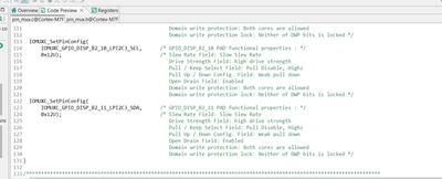

Artos
@Pavel_Hernandez
I have a solution for your questions.
Automatic value assignments of the basic parameters required for I2C3 can be configured manually via MCUXpresso (Please be care your developments).
When using I2C3 or another peripheral, please check the "Direction", "Software Input On", Pull/up/down config", "Pdrv config", "Keeper", "Open drain" in the "Routing Details" section in the "Pins" section. "Reprogram it from the beginning, taking into *** the situations.
*** If you don't using this modes, you already cannot see "IOMUX_Set_PinConfig" ...

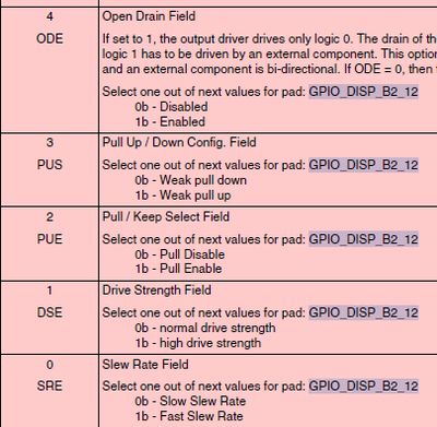

Pavel_Hernandez
Hello, I am following your case I´m researching more information, but I see you have a confusion and maybe this table clarifies that.
12.4.6.288 SW_PAD_CTL_PAD_GPIO_DISP_B2_12 SW PAD Control
The value deepens by config tool.

mimlo
Hi @Pavel_Hernandez
Making sure that both SION field and open-drain field are set for the I2C3 peripheral resolved this issue for me, but only for I2C3 peripheral. I2C4 still does not work.
All the settings are the same for I2C3 and I2C4, besides the ones that are greyed out for I2C4 as shown below:
There are some differences between I2C3 and I2C4 but they are greyed out, any idea why that is? What else could be wrong here? Should I set the greyed out options manually?
My thinking is, that when something is greyed out, it's not available for change.
Currently, for I2C4 there is a continuous clock after send transaction, and it does not stop at all.
When pinout is changed to the one mentioned in my previous post, it works correctly. What could be the issue here?
Is there some bug in the SDK or in the uc design? It seems serious.
