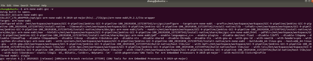

I'm using Ubuntu18.4 and SDK_2.7.0_EVKB-IMXRT1050 + gcc-arm-none-eabi-8-2019-q3-update.
boards/evkbimxrt1050/lwip_examples/lwip_ping
This demo is working fine.
boards/evkbimxrt1050/lwip_examples/lwip_udpecho
But this demo failed to initialize, just have log: Initializing PHY...
We know that the code has been executed function enet_send_frame line 336 of enet_ethernetif_kinetis.c
result = ENET_SendFrame(ethernetif->base, &ethernetif->handle, data, length);
I've tried gcc-arm-none-eabi-9-2019-q4-major or gcc-arm-none-eabi-8-2018-q4-major,still have the same problem.
SDK_2.7.0_EVKB-IMXRT1050 for iar works fine in the iar ide.
Who can help me, thank you

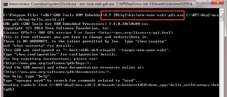

   Do you follow the Getting Started with MCUXpresso SDK for EVKB-IMXRT1050.pdf in the SDK doc folder?
   Please refer to chapter 5 Run a demo using Arm® GCC.
Do you try 4.9 2015q3 version?
Wish it helps you!

I have use gcc-arm-none-eabi-8-2018-q4-major gcc-arm-none-eabi-8-2019-q3-update and gcc-arm-none-eabi-9-2019-q4-major have the same problem.
if using OM13098(LPCXpresso board for LPC54628)+SDK_2.7.0_LPCXpresso54628+gcc-arm-none-eabi-8-2019-q3-update
lwip_examples/lwip_udpecho there's nothing wrong with this demo.
MIMXRT1020-EVK+SDK_2.7.0_EVK-MIMXRT1020 and IMXRT1050-EVKB+SDK_2.7.0_EVKB-IMXRT1050
lwip_examples/lwip_udpecho they all have the same problem.
Thanks for your help
