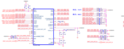

hello supporter, In My Customized imrt1176 board ,we use the ENET_QOS MAC  to connect a KSZ8081 PHY, with "enet_qos_txrx_mulitring sdk example " ,we can get the phy id from the mdio interface ,we can
auto negoiate from the remote 100M port ,but we failed at DMA reset ,following is the Schematic , please help to review it .

Hello @wangdabing .

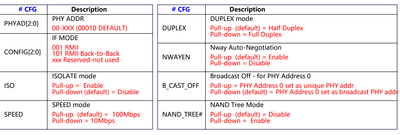

From the schematic and I can't find the obvious issue and you may check the config of the development board as the below:
