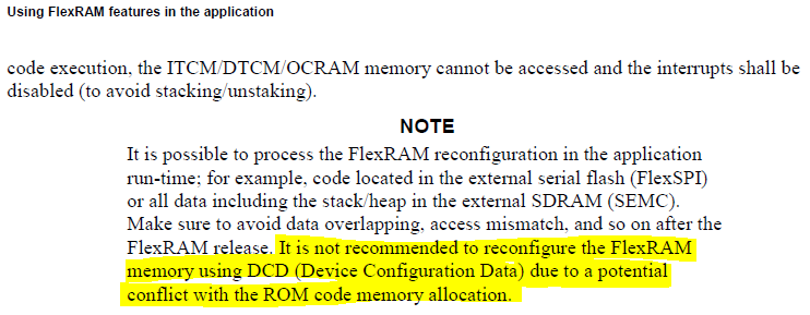

Here we we want the ROM to move code from flexispi flash into the ITCM and run, but before that want to enlarge the ICTM size( repartition the flexram). Can we access this by using the DCD code in the image head?

Hi Hu
yes this should be possible using the DCD code, as it is configured by
IOMUXC_GPR_GPR17 register and described in AN12077 Using the i.MX RT FlexRAM
https://www.nxp.com/docs/en/application-note/AN12077.pdf
Also this may be configured with fuse Default_FlexRAM_Part - Default FlexRAM RAM bank partioning
described in Table 5-9. Fusemap Descriptions i.MXRT1050 Reference Manual.

mjbcswitzerland
Specialist V
Use of DCD is explicitly advised against in the NXP application note!
