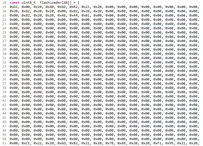

I found that flashloader is just a application which allow user to upload new image to external nor flash.
This is what MCUBootUtility just did.
I'm wondering if I could copy "ivt_flashloader.bin" into the same memory address(ocram I guess).
Is it possible to jump into this application at runtime ?
I tried but nothing happened. (FlashLoaderIAR is converted from ivt_flashloader.bin)

In the ivt_flashloader.bin, the application only occupies the space from offset address: 0x2000 to the end. So it should remove unnecessary areas except for application code prior to store in FlashLoaderIAR array.

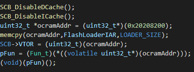

First, it should copy the flashloader bin to the area whose address starts 0x20002000, then use the below code to jump to flashloader.
    // relocate vector table
    SCB_VTOR = ocramAddr;
pFun = (Fun_t)(*((volatile uint32_t*)(ocramAddr+4)));
(void)(pFun)();

And I'm pretty sure my FlashLoaderIAR (ivt_flashloader.bin) array already located at DTC Ram
Copy FlashLoaderIAR to ocramAddr (0x20208200), then jump to this address.
It still failed.
So, I make double check to calculate checksum, the result is not the same as FlashLoaderIAR array.
Any possible step missing ?

The flashloader code also doesn't run well after jumping. And it will trigger a reset event once jumping.
I've attached my flashloader.c and my basic testing code.

Assuming this is your resect vector:
the IAR program's initial stack pointer value is 0x402000d1 and initial program counter 0x2021b26d
I presume that this means that its stack will be in external memory (SDRAM?) although it is not normal for it to be an unaligned values(?). Before jumping you will presumably need to ensure that the SDRAM has been initialised (or the DCD of the boot loader is doing this). Also you will probably need to set the stack pointer value correctly.
The jump code doesn't look right if it should be jumping to the start address (0x2021b26d). It presently jumps to the initial stack pointer address. To jump to the code it needs to first read the values and then jump to where they are pointing to and not jump to the address of where the values are stored.
