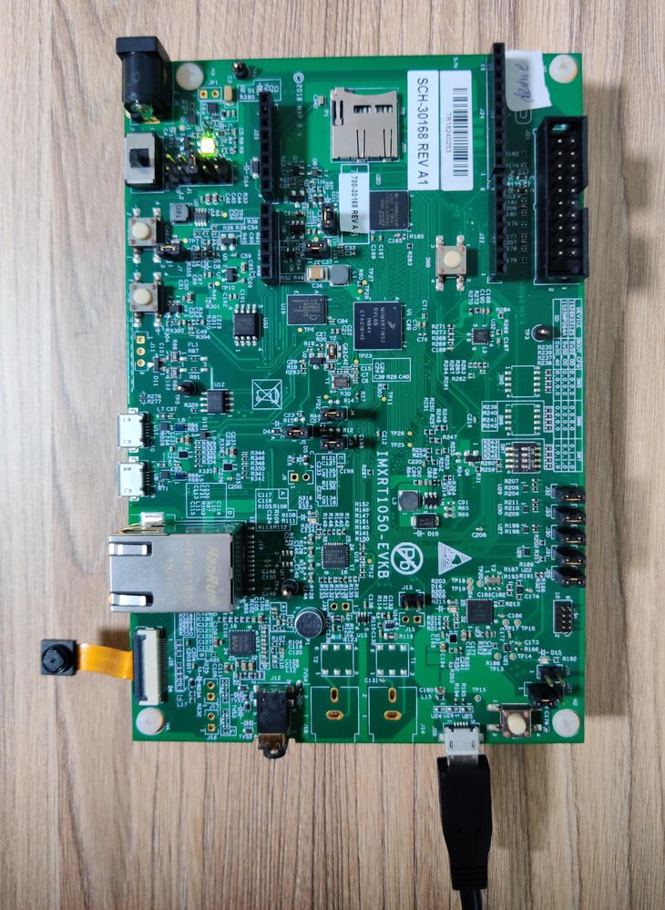

Deploy the mode to the RT MCU
  • Hardware Board: MIMXRT1050 EVK Board
Fig 1 MIMXRT1050 EVK Board
  • Template demo code: evkbimxrt1050_tensorflow_lite_cifar10

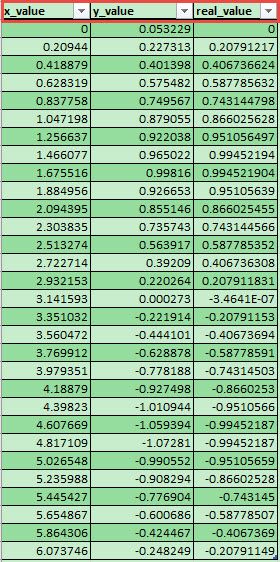

On the MIMXRT1050 EVK Board, we log the input data: x_value and the inferenced output data: y_value via the Serial Port.
Fig2 Received data
In a while loop function, It will run inference for a progression of x values in the range 0 to 2π and then repeat. Each time it runs, a new x value is calculated, the inference is run, and the data is output.
Fig3 Test result

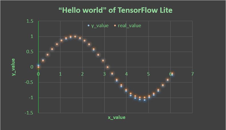

In further, we use Excel to display the received data against our actual values as the below figure shows.
Fig4 Dot Plot
You can see that, for the most part, the dots representing predicted values form a smooth sine curve along the center of the distribution of actual values. In general, Our network has learned to approximate a sine curve.
