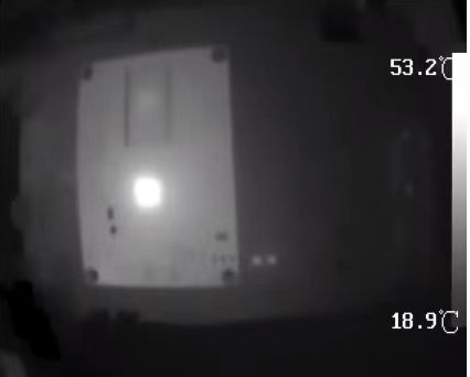

hi, i currently used nxp1176 main chip as a board.Now I encounter some problems, and I don't know where to check the problems. The current corresponding to the empty burning program is 0.03A. There is a little difference between the CPU temperature calculated according to the calculation formula in the data manual and the actual size (difference of 2 degrees), and then the overall circuit current of the burning screen display program is 0.12A (without LCD) (the current entering the CPU should be calculated). According to the calculation formula, it is 41 degrees, but the actual CPU is 56.3 degrees (the difference is very obvious).

The temperature difference between the main control calculated according to the data manual and the actual measured temperature is very large (the main control temperature calculated according to the manual is 43, but the actual temperature is 65 (captured from the thermal imager)), but all peripherals of the board can be used normally. I want to ask whether this phenomenon is normal and how to solve it if it is abnormal.

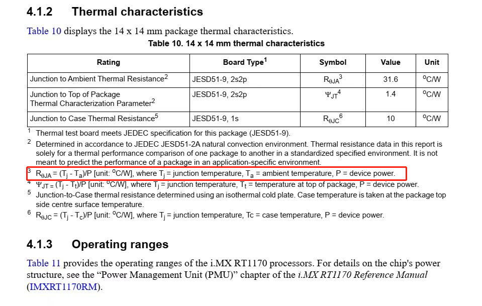

Regarding your question, it might be for several reasons, probably the environment of the mcu, mcu damaged or overcurrent on some part of the board where the mcu is mounted. In this case, I would like to know which is the formula and the page from the reference manual that you are using to calculate that temperature and what are the parameters that you are considering for that one?

In response to your question, the chips we use are purchased through official channels, and there should be no problem; The formula for calculating the temperature is calculated according to the formula in the third small point in 4.1.2 in the reference manual; Then, if the circuit of the surrounding circuit is too large, it should be very hot t微信图片_20220817161259.png
微信图片_20220817161203.pnghrough the thermal imaging analyzer. However, the thermal imaging analyzer shows that only the center of the CPU is the most heated.

Regarding I am watching at your images, and after double-checking with my teammates, this is the expected behavior, because the core in the mcu is the one that is going to be warming up, and not the modules attached to it, that's why you are seeing that heat point on your thermal camera. Then, if the temperature calculated it is not the expected, you should check the surround elements on the circuit and the clock frequency that your core is running on your application, to determine the correct temperature.
