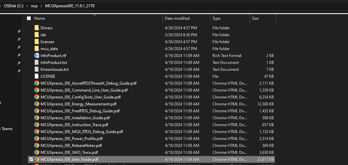

The simplest way to check instruction calls is to expand the debug window. This may provide a little bit of info to begin.
But I think that trace could also provide you information. For SWO trace  refer to  AN14071 Trace Implementation on i.MX RT1170 .   Please note that the  ULINK 2 is only supported over the CMSIS DAP in the MCUXpresso IDE and we have not done a specific testing or development for this probe. So, I could only provide general ways to get debug working.
I cannot tell if you are using FreeRTOS. But maybe MCUXpresso IDE FreeRTOS Debug Guide could work with your probe. There is also a debug guide for Zephyr and other for ThreadX RTOS. There is also some general information on the MCUXpresso User Guide Chapter 14. You will find that guide in the installation path of MCUXpresso. Check the below example.
I hope this could help you
