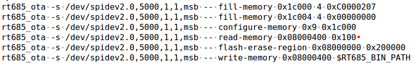

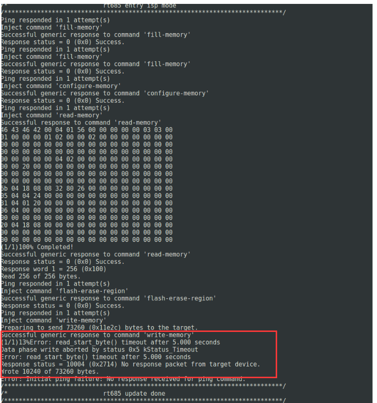

When I compile the blhost tool into the SOC and upgrade the rt685 by SPI ISP, the first few steps are successful. However, when the image is finally written to the specified address, it will report a failure to receive a response and timeout error. Can you help me to see what step the problem is? As shown in the figure below.

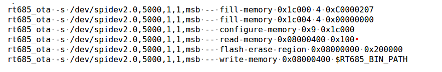

The command executed is shown in the figure below:

   Before you do the write operation(which is failed), I find you also do the erase operation, after do the erase operation, and before the write operation, could you please also readout the related write memory? Whether it is really erased or not?
   If the related area is really erased, in the write command, please enlarge your timeout time from 5000 to a longer time, do you calculate the write time about the SPI, whether your 5000 is enough to write the related area? Can you try to write just some bytes, whether it can be successful or not?

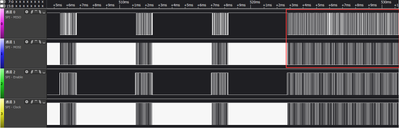

In the case of failure timeout, I use logic analyzer to analyze as follows:
Each packet is sent in 512 bytes. Before the next normal transmission, it will receive the rt685 return of 0x5a and 0xa1, which means start byte and packet type ack.

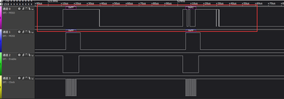

In the case of failure timeout, the SoC side has not received start byte 0x5a, but only received packet type ACK 0xa1.
Areas of failure above:

So does SPI ISP need additional commands?
