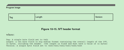

Hi @gsbalajikrishnan ,
   Please read the RT1160RM, chapter 10.7 Program image at first, you will get the information.
About the IVT header, you also can find it from SDK code:
This is the IVT header area in the app IMAGE:
Normally, to the customer, you don't need to modify this header, just use it is OK, and put it from offset 0X1000.
Wish it helps you!
kerry

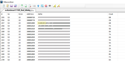

gsbalajikrishnan
Hello @kerryzhou ,
I am using Secure Provisioning Tool 5.0
I am getting the same offset 0x1040 of DCD while using SPT instead of getting offset 0x1030
I mentioned the IVT table given below
kindly suggest
Thanks & Regards,
Balajikrishnan.G.S
