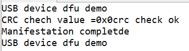

      I am trying to update the firmware in the RT1170 using the "evkmimxrt1170_dev_dfu_freertos_cm7" example by following the document given I'm able to load the given "dev_hid_mouse_bm.bin" example to the RAM and it is working fine. But when I load my own bin file it is loading but not executing. I have removed the XIP boot header and added the CRC check to it. After loading the file it is again returning back to the DFU application immediately without executing the loaded file.

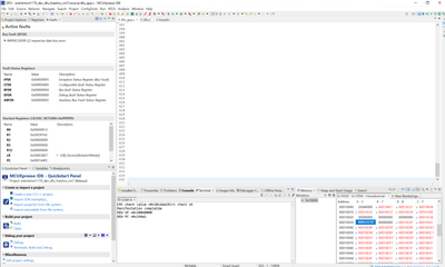

                    I have tried both the DFU and MCU Boot Utility by generating the bin file by disabling the XIP_BOOT_HEADER & XIP_EXTERNAL_FLASH with the reference of https://github.com/JayHeng/NXP-MCUBootUtility  But still I'm getting faults while loading the image through the DFU or MCU boot utility.
Can you please help me regarding this issue.
1. I just want to generate an image file that can run in the Rt1170 when loaded through the DFU or MCU boot utility.
2. How to generate a RAM image that run from RAM when loaded through the DFU example.

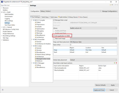

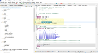

Totally, the issue is due to the offset of the image. Please check the code snip:
Because of the design in the DFU program, address offsets need to be modified in ITC:
Take led_blink as an example, please follow the steps below:
1. select link to ram in MCUXpressolink:

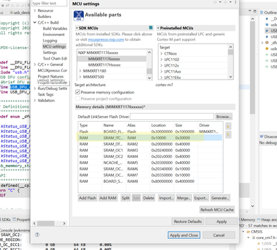

2. Modify the MEMORY as shown:
3. Add the crc and you're ready to go.
I have attached the bin file that is already available, the file with the suffix "_1" is the one that has been header added. Please test it.

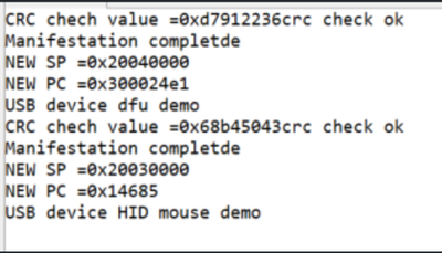

          I found that my image file is loading to ROM (QSPI)and at the same time MSP pointing to ram and the PC is pointing to QSPI flash. But for the given example bin file when I loaded it.
It is also loading to the ROM but the MSP and PC both are pointing to the RAM only.
So, I just want to know how to generate the binary file just like the example "dev_hid_mouse_bm.bin" file provided in the example "evkmimxrt1170_dev_dfu_freertos_cm7".
I followed this A way to create a binary that is copied to RAM fro... - NXP Community   and modified the image.
