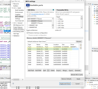

Totally, the issue is due to the offset of the image. Please check the code snip:
Because of the design in the DFU program, address offsets need to be modified in ITC:
Take led_blink as an example, please follow the steps below:
1. select link to ram in MCUXpressolink:
2. Modify the MEMORY as shown:
3. Add the crc and you're ready to go.
I have attached the bin file that is already available, the file with the suffix "_1" is the one that has been header added. Please test it.
Happy new year!
Gavin
