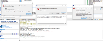

dev_cdc_vcom_freertoc_cm7 example USB app does not work from SDK v12.1 with the 1170 EVK. If I try to debug the code, the debugger crashes and leaves the EVK in a state where I cannot reflash it. See screenshot below of all the unintelligble errors that pop up when trying to flash a simple HelloWorld program.
erling_0-1670631517287.pngTo overwrite the application with something that is not broken I must hold down the reset button while pressing Debug in MCUXpresso and release reset button when it tries to attach, in this way it can intercept the core before reaching a faulty (low power sleep?) mode.
Very frustrating to work with, I am surprised by how buggy and brittle the flashing/debugging experience still is with the iMXRT1170 EVK...

I review your image and I recommend doing a mass erase, with the tool below.

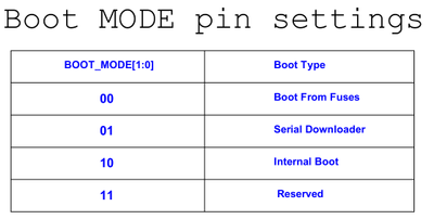

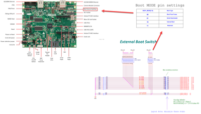

3. Go to your RT1170-EVK and locate SW1.
4. Change to serial boot loader
5. At this point, you need to do a power-cycle to your board (disconnect and connect the power), so the changes in SW7 take effect.

11. Go to your board and change the SW1 back to the way
12. Do a power cycle to your evaluation board.

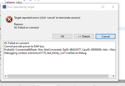

Thanks for your suggestion, however it does not work. I had already tried using serial bootloader and the MCU Boot Utility. But it is not able to get contact with the CPU. The LED next to the USB connector (D5?) is just blinking red with constant period. What are my other options?
777 Views
CarlosGarabito
Your J38 is jumped on 1-2? are you using a cilinder power? or is jumped 3-4 and you are using a usb2 as a power board? check that part, because the last error that you have is no power DAP.
