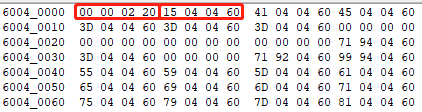

Hi! Please Look at this problem for me.
In the bootloader,the code is:
uint32_t *appVectorTable = (uint32_t *)APPLICATION_ADDRESS;
applicationAddress = appVectorTable[kInitialPC];
stackPointer = appVectorTable[kInitialSP];
jump_to_application(applicationAddress,stackPointer);

Hi @shengbing ,
It seems no problem in these code. Is the bootloader work in RAM and jump to flash base app? Is the PC and stack address read back correct?

Hi,@Jing,
The bootloader is working in external flash.The PC and stack address are 0x60040415 and 0x20020000, respectively, by reading back.
Please see the file named <MIMXRT1062xxxxx_flexspi_nor.scf>  for the relevant configuration.

Hi @shengbing ,
I tested your bootloader. At first it can't work too. Then I set the compile optimization option to -O1. It can work. After that, Then I exchange the __set_MSP() and __set_PSP() position and return back to -O0, it can work too.
__ISB() and __DSB() is useless to this case. So I think this is compiler problem but I don't know why.
