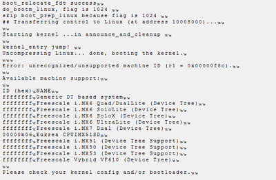

Now when we try to use mfgtool to flash, it gets stuck in the kernel and it seems to have unmatched machine id.
The id passed by uboot is f8c which is correct for imx6q, but the ids in kernel seems strange, all "ffffffff", do you know what can be wrong?
