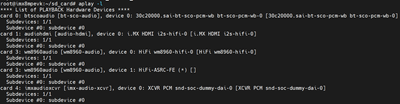

Hello, I hope you are doing well.
Could you please send me the log of next command?
aplay -l
With this you can see the card options to play audio, the headphone jack uses the WM8960 codec.
And the command to play audio should be something like:
aplay -Dplughw:3,0 sample.wav
Example:
Best regards.

root@imx8mp-lpddr4-evk:~# aplay -l
**** List of PLAYBACK Hardware Devices ****
card 0: btscoaudio [bt-sco-audio], device 0: 30c20000.sai-bt-sco-pcm-wb bt-sco-pcm-wb-0 [30c20000.sai-bt-sco-pcm-wb bt-sco-pcm-wb-0]
Subdevices: 1/1
Subdevice #0: subdevice #0
card 2: imxaudioxcvr [imx-audio-xcvr], device 0: XCVR PCM snd-soc-dummy-dai-0 [XCVR PCM snd-soc-dummy-dai-0]
Subdevices: 1/1
card 3: audiohdmi [audio-hdmi], device 0: i.MX HDMI i2s-hifi-0 [i.MX HDMI i2s-hifi-0]
Subdevices: 1/1

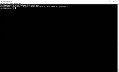

root@imx8mp-lpddr4-evk:~# aplay -Dplughw:3,0 sample.wav
sample.wav: No such file or directory
.bash_history .config/ .nxp-demo-experience/ 10-Crazy-Frog-Axel-F.mp3
.cache/ .lesshst .profile gstshark_2023-10-19_11:29:09/
root@imx8mp-lpddr4-evk:~# aplay -Dplughw:3,0 10-Crazy-Frog-Axel-F.mp3
Playing raw data '10-Crazy-Frog-Axel-F.mp3' : Unsigned 8 bit, Rate 8000 Hz, Mono (I was not able to listen)

Got it, you need to change your device tree on U-boot to imx8mp-evk.dtb as is showed on the next image:
Now, you will be able to see the CODEC on aplay -l play audio through headphone jack:
