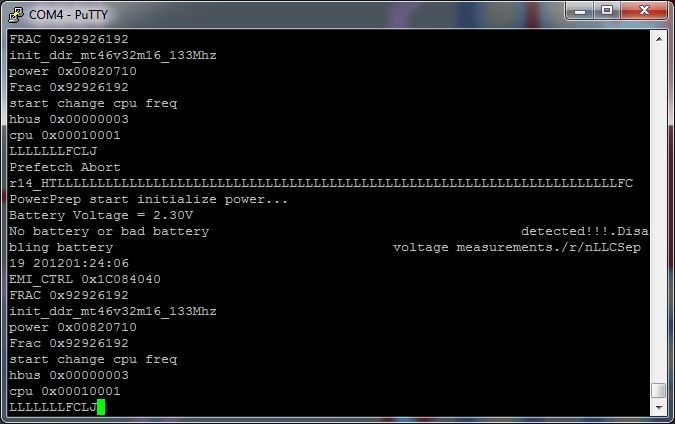

I made my own board and I can run Linux on it from sdcard. I tried SD card that works well on the board Olinuxino-maxi, but when testing on my board is not working and will output: (Arch Linux 2.6.35.8
I then tried Linux created using pages
http://archlinuxarm.org/platforms/armv5/olinuxino
which is the output
could you give me some advice?
2,790 Views
mistrlukáš
I now everything works. the problem was one way to memory. I would like to ask if there is any simple program to test the external RAM memory.

igorpadykov
Hi Mistr
I would suggest to check sources for "SD card that works well on the board
Olinuxino-maxi" and add debug prinfs to bootlets, this will give you place in
program where brownout occured. Also recommended to check schematic - it
should strictly follow schematic for which this image was generated.
Since PMU is fully programmable module, some settings may be changed
for new board. Also if another DDR used, then use tool below
Re: i.mx28 u-boot dram configuration for dram replacement.
igor

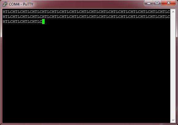

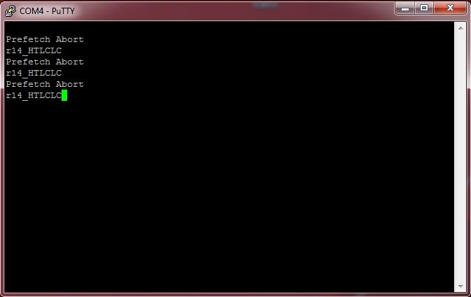

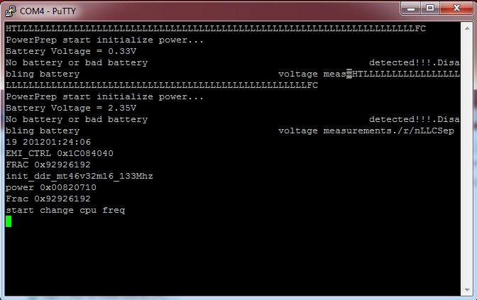

mistrlukáš
I have now solved the problems with the board and found problems with the power supply.  Otherwise I have two different systems and they stuck me in the following steps.

igorpadykov
When enabled, the ROM will output a single character on the debug UART
for every boot command it executes, with no whitespace between characters.
See the table below for the characters output for each command.
The result of a successful boot looks something like "LLFLLLJ".
Char     Command     Notes
J     Jump     After a jump, the application that was jumped to can re-use
            the memory in on-chip RAM (which ROM was using), since ROM will not
           expect this application to return.  This is the key difference between a Call and a Jump,
           the ROM expects an application that was called to return.
C     Call     ROM expects the application to return.
L     Load
F     Fill
H     Header
T     Tag     Tag was encountered while parsing
for power supplies suggest to check
AN4199 Using the i.MX28 Power Management Unit and Battery Charger
IMX28_EVK_DESIGN_FILES_R10 : i.MX28 EVK Design Files: Hardware Schematics
