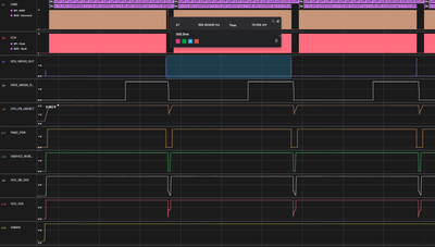

We are integrating an i.MX 8QuadMax and are experiencing intermittent failures of SanDisk brand 32GB microSD cards in our development units.

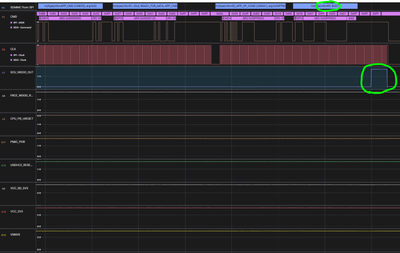

With a protocol analyzer on bootup (this microSD card is the OS boot source) and a *failed* card, I see the i.MX 8 send a CMD0 (reset), then CMD8 (check supplied voltage), then a CMD55 (APP_CMD) and ACMD41 (send operating condition register). The CMD55 and ACMD41 commands are continuously sent until the i.MX 8 resets itself after about 300mS. Bus analysis shows that the ACMD41 response "Busy Status" bit is never set, therefore the card has not completed initialization and the i.MX 8 resets before it ever does.

We have observed that with the SanDisk Extreme, Western Digital, Industrial, and other brand microSD cards that after strenuous use our system no longer boots up. Upon probing the SDIO bus we observe the CMD0, CMD8, and then CDM55 and ACMD41 repeatedly issued for roughly 300mS before a system reset occurs. I believe this is because these cards have not ~yet~ set their “Busy Status” bit and therefore their file system contents cannot yet be accessed. This system reset originates from a Watchdog strobe event on the i.MX 8 SCU_WDOG_OUT pin.
I read in the “SD Specifications Part 1 Physical Layer Simplified Specification Version 9.10” document in section 4.2.3 that “The host repeatedly issues ACMD41 for at least 1 second or until the busy bit are set to 1.” This reads to me like the i.MX 8 violates SD specification by not allowing 1 full second after the first ACMD41 message for the card to become ready.
We believe we've identified the source of this Watchdog event - the SECO hardware reset timer. The i.MX 8 Hardware Reference Manual states in section 5.7.3.3 that "There is a hardware reset timer enabled by default on the SECO side. The timeout of this timer is 300ms...". Since the firmware resides on the microSD card and the CPU/PMICs execute a system-wide power cycle before the microSD card is ready, our system gets caught in a boot-reset loop indefinitely.
