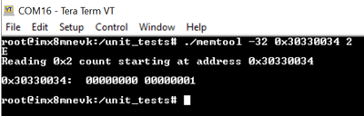

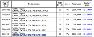

You can use the memtool but for iMX8M is not defined the macros.
To use the memtool you have to put the direction that you can read/ write instead of the name of the register.
for the register "IOMUXC_SW_MUX_CTL_PAD_GPIO1_IO03" you can do the next:

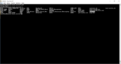

The memtool is supported for iMX8M.
The tools are integrated directly into our bsp.
You can check in the folder /unit_test of our bsp.
