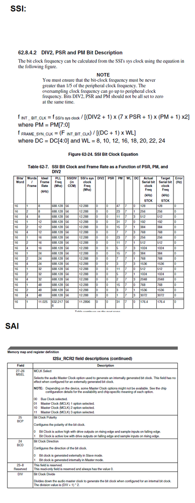

BiyongSUN
You mentioned is SSI or SAI interface?
