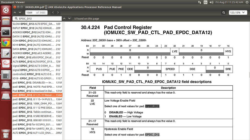

I have IMX6SLEVK.
I want to toggle a free GPIO i.e. GPIO1_14 from userspace /sys/class/gpio.
But when I export this GPIO1_14 by the below steps, I do not see the values getting to '1':
     echo 14 > /sys/class/gpio/export
     echo out > /sys/class/gpio/gpio14/direction
     echo 1 > /sys/class/gpio/gpio14/value
Please do let me know if I need to do anything else for the same.
I am probing the MX6SL_PAD_EPDC_D7_GPIO_1_14 pad on the board.

alik
When GPIO pin is configured as output, it cannot be read, in general. Reading its value will produce the result you see. In order to be able to read output pins they have to be configured in a special way, I remember reading that in the Reference manual. I have not done it myself, so I can only recommend reviewing GPIO section of the Reference Manual for which bits must be set and in which registers.
Alex
6,843件の閲覧回数
fabio_estevam
When a GPIO pin is configured as an output it is possible to read its value back by setting the SION bit of the pad.
Fabio Estevam
6,843件の閲覧回数
bhayani_sunny
I am able to configure the GPIO from userspace from /sys/class/gpio.
I did changes in the arch/arm/boot/dts/imx6sl-evk.dts file.
I added the below lines in the hoggrp for iomuxc group:
     MX6SL_PAD_EPDC_D7__GPIO1_IO14     0x110b0
     MX6SL_PAD_EPDC_D6__GPIO1_IO13     0x110b0
But can anybody please let me know, what the above values mean. Because I tried to use this pins with the values -->0x1b0b0 and 0x80000000, but it was not working for me.
Then I referred to the BSP Porting Guide for iMX6SL and there it is mentioned that the values corresponds to Hysteresis, Pull up/Pull down, etc but I am not able to see exact bit mappings for the above values.
It would be great if someone can point me out to the values.
Sunny

bhayani_sunny
Hi Tom,
Thanks for the pointers. It helped.
I downloaded the iMX6SL RM which Igor has mentioned below, and then I checked my EPDC_D7 pad and looked at the Bit settings for the whole pad name i.e. MX6SL_PAD_EPDC_D7__GPIO1_IO14 and there it is mentioned what each bit or bitfields mean i.e. Hys, PKE, PKU, Speed, DSE, etc.
We need to manually calculate the whole 32-bit pad value by looking at the PAD Control Register of the corresponding Pad and enter it in the DTS file.
Below is snapshot for someone trying to look for the same:
Thanks a lot for the info.
