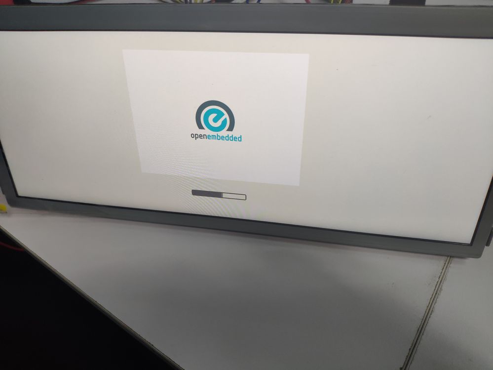

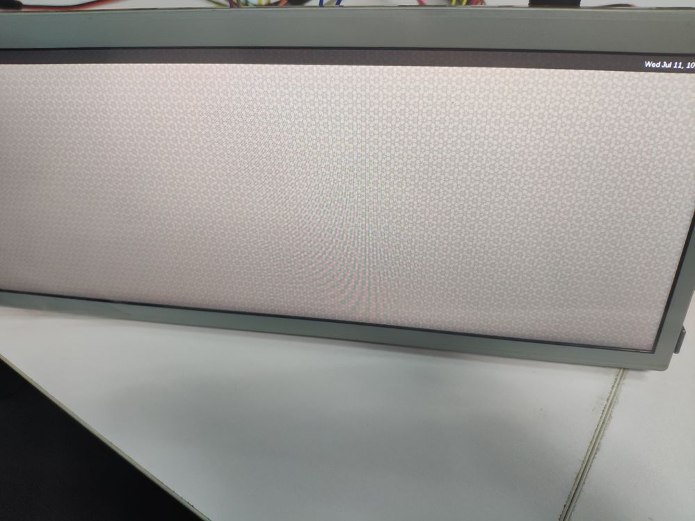

      I have a question that I'd like to ask you about. After the system is migrated, the display will close after a few minutes (about 5 minutes). The contents displayed after starting up are as follows:
(1) Login
(2) Backgound picture
(3) After about 5 minutes, the screen will be black, but the backlight is still on, and the terminal console can control it. Running the display program will not work, and the console will be stuck. The information of my transplanted system is as follows:

jack-chen
hello,
   I tried the following command:
echo -e ‘\033[9;0]’ > /dev/tty0
echo -e ‘\033[9;0]’ > /dev/tty1
echo 0 > /sys/class/graphics/fb0/blank
echo 0 > /sys/class/graphics/fb1/blank
It doesn't work. Actually, my console device is tty1 and the framebuff is fb0.
