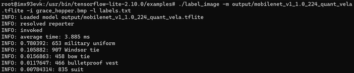

I tried to replicate this issue and I could run successfully the example model mobilenet_v1_1.0_224_quant.tflite located at /usr/bin/tensorflow-lite-2.10.0/examples.
In your example you are using the command:
root@imx93evk:/usr/bin/tensorflow-lite-2.10.0/examples# ./label_image -m mobilenet_v1_1.0_224_quant_vela.tflite external_delegate_path=/usr/lib/libethosu_delegate.so
For the i.MX93 you don’t need to describe an external_delegate_path. The model compiled with vela command is automatically detected and runs on the NPU EthosU.
Please try with the following command:
root@imx93evk:/usr/bin/tensorflow-lite-2.10.0/examples# ./label_image -m output/mobilenet_v1_1.0_224_quant_vela.tflite -i grace_hopper.bmp -l labels.txt
You will see an output like this:
Notice that the average inference time is 3.885 ms.
If we use the mobilenet_v1_1.0_224_quant.tflite without "vela", the model runs on the CPU.
Notice the average inference time is 135.001 ms.
I hope this information will be helpful.

thanks a lot for your support! I can confirm that the mobilenetV1 model works with the ethosu accelerator, with and without specifying the delegate.
I just discovered that the described error occured after i tried to run a converted efficientdet-lite2 model (from tensorflow-lite model maker) which doesn't seem to work. So after i ran this model which threw the same error, i also couldn't run the mobilenet models on ethosu anymore. Only a reboot of the board fixed this issue for the mobilenet models.
I am still wondering why the efficientdet-lite2 model doesn't work because the vela compiler doesn't throw any errors, just warnings of placing unsupported operations on the CPU.
