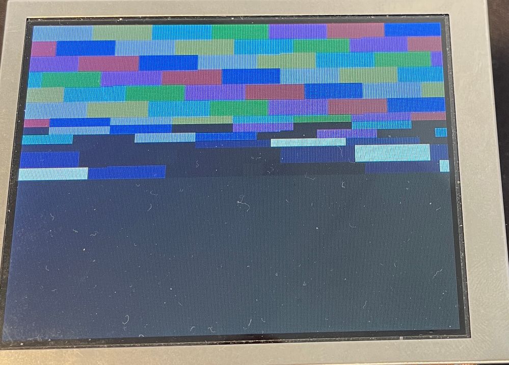

Dear Sirs,
We are running i.MX8MM with Linux kernel 6.1 with weston. The display TST350MTQI has ILI9341 driver and we are using the mi0283qt kernel driver from drivers/gpu/drm/tiny. Electrical onnection is 3-wire SPI to ECSPI1 on i.MX8.
The display looks to be set up ok when running modetest:

However, the issue is that the picture shown is misaligned repeatedly when running modetest:
root@imx8mmea-ucom:~# modetest -M mi0283qt -s 31@34:320x240@RG16
modetest display resultmodetest display result
With the SPI- & drm-debug enabled it shows this when running modetest as above:
[ 515.462802] [drm:drm_ioctl] comm="modetest" pid=463, dev=0xe200, auth=1, DRM_IOCTL_MODE_DIRTYFB
[ 515.462830] [drm:drm_mode_object_get] OBJ ID: 37 (3)
[ 515.462843] [drm:drm_mode_object_get] OBJ ID: 40 (1)
[ 515.462888] [drm:mipi_dbi_fb_dirty] Flushing [FB:37] 320x240+0+0
[ 515.464125] [drm:mipi_dbi_typec1_command] cmd=2a, par=00 00 01 3f
[ 515.464166] spi_imx 30820000.spi: mx51_ecspi_clkdiv: fin: 50000000, fspi: 10000000, post: 0, pre: 4
[ 515.464190] spi_imx 30820000.spi: mx51_ecspi_clkdiv: fin: 50000000, fspi: 10000000, post: 0, pre: 4
[ 515.464209] [drm:mipi_dbi_typec1_command] cmd=2b, par=00 00 00 ef
[ 515.464225] spi_imx 30820000.spi: mx51_ecspi_clkdiv: fin: 50000000, fspi: 10000000, post: 0, pre: 4
[ 515.464243] spi_imx 30820000.spi: mx51_ecspi_clkdiv: fin: 50000000, fspi: 10000000, post: 0, pre: 4
[ 515.464262] [drm:mipi_dbi_typec1_command] cmd=2c, len=153600
[ 515.464278] spi_imx 30820000.spi: mx51_ecspi_clkdiv: fin: 50000000, fspi: 10000000, post: 0, pre: 4
[ 515.464422] spi_imx 30820000.spi: mx51_ecspi_clkdiv: fin: 50000000, fspi: 32000000, post: 0, pre: 1
[ 515.472009] spi_imx 30820000.spi: mx51_ecspi_clkdiv: fin: 50000000, fspi: 32000000, post: 0, pre: 1
[ 515.479986] spi_imx 30820000.spi: mx51_ecspi_clkdiv: fin: 50000000, fspi: 32000000, post: 0, pre: 1
[ 515.487228] spi_imx 30820000.spi: mx51_ecspi_clkdiv: fin: 50000000, fspi: 32000000, post: 0, pre: 1
[ 515.494799] spi_imx 30820000.spi: mx51_ecspi_clkdiv: fin: 50000000, fspi: 32000000, post: 0, pre: 1
[ 515.502419] spi_imx 30820000.spi: mx51_ecspi_clkdiv: fin: 50000000, fspi: 32000000, post: 0, pre: 1
[ 515.509996] spi_imx 30820000.spi: mx51_ecspi_clkdiv: fin: 50000000, fspi: 32000000, post: 0, pre: 1
[ 515.517862] spi_imx 30820000.spi: mx51_ecspi_clkdiv: fin: 50000000, fspi: 32000000, post: 0, pre: 1
[ 515.525768] spi_imx 30820000.spi: mx51_ecspi_clkdiv: fin: 50000000, fspi: 32000000, post: 0, pre: 1
[ 515.533764] spi_imx 30820000.spi: mx51_ecspi_clkdiv: fin: 50000000, fspi: 32000000, post: 0, pre: 1
[ 515.541703] spi_imx 30820000.spi: mx51_ecspi_clkdiv: fin: 50000000, fspi: 32000000, post: 0, pre: 1
[ 515.549667] spi_imx 30820000.spi: mx51_ecspi_clkdiv: fin: 50000000, fspi: 32000000, post: 0, pre: 1
[ 515.557632] spi_imx 30820000.spi: mx51_ecspi_clkdiv: fin: 50000000, fspi: 32000000, post: 0, pre: 1
[ 515.565532] spi_imx 30820000.spi: mx51_ecspi_clkdiv: fin: 50000000, fspi: 32000000, post: 0, pre: 1
[ 515.573502] spi_imx 30820000.spi: mx51_ecspi_clkdiv: fin: 50000000, fspi: 32000000, post: 0, pre: 1
[ 515.581434] spi_imx 30820000.spi: mx51_ecspi_clkdiv: fin: 50000000, fspi: 32000000, post: 0, pre: 1
[ 515.589395] spi_imx 30820000.spi: mx51_ecspi_clkdiv: fin: 50000000, fspi: 32000000, post: 0, pre: 1
[ 515.597363] spi_imx 30820000.spi: mx51_ecspi_clkdiv: fin: 50000000, fspi: 32000000, post: 0, pre: 1
[ 515.605238] spi_imx 30820000.spi: mx51_ecspi_clkdiv: fin: 50000000, fspi: 32000000, post: 0, pre: 1
[ 515.610917] [drm:drm_mode_object_put.part.0] OBJ ID: 40 (2)
[ 515.610947] [drm:drm_mode_object_put.part.0] OBJ ID: 37 (4)
[ 515.610965] [drm:drm_mode_object_put.part.0] OBJ ID: 37 (3)
[ 515.610991] [drm:drm_mode_object_put.part.0] OBJ ID: 41 (1)
[ 515.610996] [drm:drm_ioctl] comm="modetest" pid=463, dev=0xe200, auth=1, DRM_IOCTL_MODE_SETGAMMA
[ 515.611017] [drm:drm_ioctl] comm="modetest", pid=463, ret=-38
This shows that the data over SPI is sent in chunks due to what I believe might be some memory constraint (?).

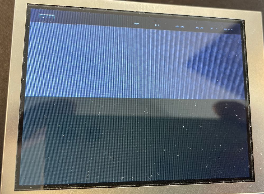

Similar debug output when starting weston:
root@imx8mmea-ucom:~# systemctl restart weston

And display result shows same issue on weston desktop:
weston display outputweston display output
Also, both pictures show only ~half screen is filled with data.
Please help us finding the root cause to this issue, the driver and LCD is widely used elsewhere as far as we can see.
