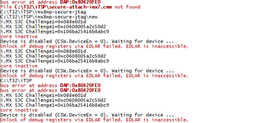

We have previously inquired about this issue:
https://community.nxp.com/t5/i-MX-Processors/i-MX8M-Plus-Is-secure-jtag-a-trace32-demo-script-execut...
Following the support from NXP technical team, we received a Trace32 script, and it seemed to work correctly when executed with this script. However, this operation was successful only when the secure JTAG-related efusing was performed (SJC_RESP, SJC_RESP_LOCK, JTAG_SMODE).
We added efusing specific to our product as follows:
/* SRK_HASH[255:0] - SRK write */
fuse prog -y 6 0 <confidential>
fuse prog -y 6 1 <confidential>
fuse prog -y 6 2 <confidential>
fuse prog -y 6 3 <confidential>
fuse prog -y 7 0 <confidential>
fuse prog -y 7 1 <confidential>
fuse prog -y 7 2 <confidential>
fuse prog -y 7 3 <confidential>
/* SEC_CONFIG[1]    - 0x470[25] - Closed device */
/* BOOT_MODE_FUSE   - 0x470[15:12] - eMMC Boot */
/* BT_FUSE_SEL      - 0x470[28] - enable eFuse BOOT_MODE */
/* JTAG_SMODE[1:0]  - 0x470[23:22] */
fuse prog -y 1 3 0x12402000
/* WDOG_EN          - 0x480[10] - Watchdog reset counter enable *
fuse prog -y 2 0 0x400
/* USDHC_PWR_EN     - 0x490[7] - eMMC reset enable */
/* IMG_CNTN_SET1_OFFSET - 0x490[22:19] - Secondary Image Boot Offset (8mb) */
fuse prog -y 2 1 0x180080
/* SJC_RESP[63:0]   - 0x600-0x610 */
/* SJC_RESP[127:64] - 0x7D0-0x7E0 */
fuse prog -y 8 0 0x12345678
fuse prog -y 8 1 0x9abcdef0
fuse prog -y 15 1 0x12345678
fuse prog -y 15 2 0x9abcdef0
/* SJC_RESP_LOCK    - 0x400[10] */
/* SRK_LOCK         - 0x400[9] */
/* BOOT_CFG_LOCK    - 0x400[3:2] */
fuse prog -y 0 0 0x604
trace32 area log:
Are there any other values besides the secure JTAG-related efusing that might have an impact? Or could there be another reason? We are looking forward to your prompt response.

Upon further investigation, we have confirmed that when proceeding with SEC_CONFIG[1] - 0x470[25] - Closed device, we are unable to perform the attach. It seems that HAB is affecting the SJC in this case.

The issue has not been resolved. We require secure boot functionality, and for this, we need to use the device closed state (SEC_CONFIG[1] - 0x470[25]).
We mentioned that among several efusing data we applied, SEC_CONFIG[1] - 0x470[25] was the issue. We hoped for a quicker response as the NXP technical support team is aware of this and has looked into it.
Please provide guidance on how to use Secure JTAG while using our efusing.
