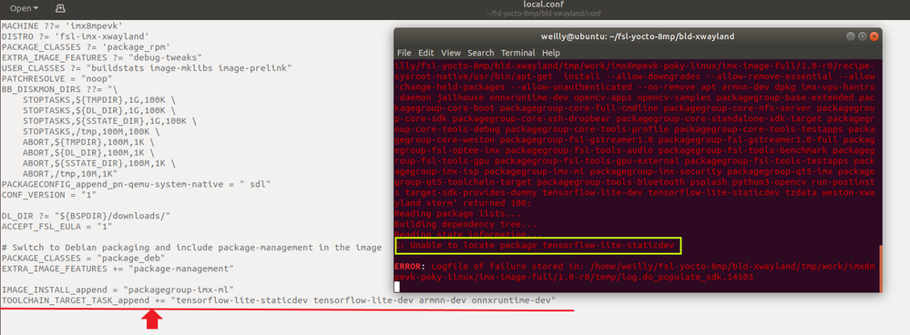

(1) Build BSP L5.10.35.2.0.0 SDK of i.MX8MPlus
      $ source ./imx-setup-release.sh -b bld-xwayland      $ Add in local.conf
         IMAGE_INSTALL_append += " packagegroup-imx-ml"
         TOOLCHAIN_TARGET_TASK_append += "tensorflow-lite-dev armnn-dev  onnxruntime-dev"
      $  bitbake -c populate_sdk imx-image-full
       Tip :  tensorflow-lite-staticdev package has some problem for this version

weilly_li
Hi, @Bio_TICFSL
      i have confirmed add it . so I know this toolchian's problem of "tensorflow-lite-staticdev"
      BSP : L5.10.35.2.0.0
      Platform : NXP i.MX8MPlus
Weilly
