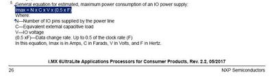

igorpadykov
Hi Janarthanam
such issue may be caused by capacitance of USDHC1 CLOCK line (probably due to
long cable) and signal loss at higher frequencies. It can be estimated using formula
in Table 14. Maximum Supply Currents   i.MX 6UltraLite Applications Processors for Consumer Products Data Sheet
igor
