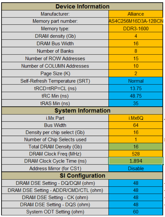

I have developed i.MAX6 processor based custom hardware design and for that I have used Alliance AS4C256M16D3A-12BCN RAM (Data Sheet for RAM ) I could flash the Boot ROM of the processor from uboot by using USB OTG interface and now I'm stuck at DDR MEMORY CALIBRATION.
1. In order to bringing up a custom hardware I think first we should do the DDR memory calibration and include the read and write level calibrations to uboot. Is this correct ? Do we have any thing to do before this ?
2. So when I'm running the DDR calibration using ddr_stress_tester_v2.60  software it shows "ERROR FOUND, we can't get suitable value !!!! dram test fails for all values.. "

So it may be bad PCB layout or incorrect Script. But I did the script editing according to the RAM Data sheet. This is the changed excel sheet. Can you find any mistake in this according to the given RAM DATA SHEET ? If the problem is with the BAD PCB layout how I can confirm it whether BAD PCB or incorrect script ?

  Please look at hints below regarding the issue.
  You may try to decrease memory frequency till  400 MHz.
  Perhaps the problem relates to some inaccuracy in memory PCB design.
  You may use sections 3.3.1 (Identifying Issue on Calibrations) and 3.3.2 (Identifying
Issue on Stress Test) of the following document.
Freescale i.MX6 DRAM Port Application Guide-DDR3
  Please check Your PCB design using Chapter 3 (i.MX 6 Series Layout Recommendations)
of the Hardware Development Guide. In particular, please use Excel page named “MX6 DRAM
Bus Length Check” in “HW Design Checking List for i.Mx6”.
HW_Design_Checking_List_for_i.MX6DQP6DQ6SDL
