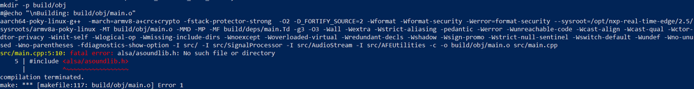

If you have extracted the toolchain from Yocto it should be correct. You can generate a .sh to install the toolchain using Yocto with the following command:
$ bitbake imx-image-multimedia -c populate_sdk
The default path for installing the toolchain is /opt, your toolchain should have the asound header on a couple of paths. If this is not available there may be a problem with the toolchain.
/opt/<DISTRO>/<BSP>/sysroots/armv8a-poky-linux/usr/include/sys/asoundlib.h
/opt/<DISTRO>/<BSP>/sysroots/armv8a-poky-linux/usr/include/asoundlib.h
/opt/<DISTRO>/<BSP>/sysroots/armv8a-poky-linux/usr/include/alsa/asoundlib.h
As for the Real Time Edge image, it does not include the AFE so you would need to install it manually. You may copy the files from /unit_tests/nxp-afe and /usr/lib/nxp-afe/ to the same paths on the Real Time Edge image to run the AFE.
The asound.conf file ready to be used with the AFE is available in /unit_tests/nxp-afe/asound.conf
For the i.MX8MM you may use the default asound.conf available in this directory. There are separate configurations for other boards or configurations.
I hope that this information helps.

1, it will happen error when I build https://github.com/nxp-imx/nxp-afe. It can't found alsa/asoundlib.h, Could you help check it?

1), My toolchain is get from the folder build_folder/tmp/deploy/sdk/ after build the yocto sdk successfully. Is it different with what you said. Could you tell me how to extract the toolchain from the Yocto BSP and use it to build the AFE. Because using bitbake nxp-afe build the AFE, it will use the default setup and I can't change the setup and code.
