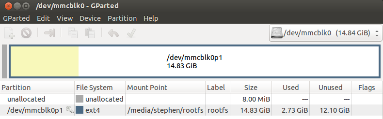

Simply replacing the uImage on my currently working SD card from the L3.0.35_13.10.02 images (sudo dd if=uImage of=/dev/mmcblk0 bs=512 seek=2048 conv=fsync) results in the boot process getting to "Starting kernel" then hanging indefinitely. The same result also occurs when using the generated version of u-boot as well.
Interestingly though, simply using the generated core-image-base-imx6slevk.sdcard image ($ sudo dd if=core-image-base-imx6slevk.sdcard of=/dev/mmcblk0 bs=1M) also results in the same behavior.
I am a bit uncertain as to how my SD card should be partitioned for use with the Yocto images.
The partitions on the SD card with the L3.0.35_12.10.20 images (which run successfully) appear as such:
(with u-boot and the uImage dd'd to the unallocated space before mmcblk0p1)
The partitions on the SD card dd'd from the .sdcard image, however, appear like this:
(with the uImage, dtb and ldo-dtb on the fat partition and u-boot *presumablly?* on the unallocated space just before the fat partition)

So, this looks good.
Even though the do_rootfs failed, the following files were still generated, much like before:
modules--3.10.9-r0-imx6slevk-20140120181707.tgz
u-boot-imx6slevk.imx
uImage-imx6slevk.bin
modules-imx6slevk.tgz
uImage
uImage-imx6sl-evk.dtb
README_-_DO_NOT_DELETE_FILES_IN_THIS_DIRECTORY.txt
uImage--3.10.9-r0-imx6slevk-20140120181707.bin
uImage-imx6sl-evk-ldo.dtb
u-boot.imx
uImage--3.10.9-r0-imx6sl-evk-20140120181707.dtb
u-boot-imx6slevk-2013.04-r0.imx
uImage--3.10.9-r0-imx6sl-evk-ldo-20140120181707.dtb
A lot of them appear to be symlinks? Why is that?
Copying uImage--3.10.9-r0-imx6slevk-20140120181707.bin  (renamed uImage), uImage--3.10.9-r0-imx6sl-evk-20140120181707.dtb (renamed imx6sl-evk.dtb), and uImage--3.10.9-r0-imx6sl-evk-ldo-20140120181707.dtb (renamed imx6sl-evk-ldo.dtb) to the Boot partition of the SD card created with an earlier .sdcard image, as well as dd'ing u-boot-imx6slevk-2013.04-r0.imx (sudo dd if =u-boot-imx6slevk-2013.04-r0.imx of=/dev/mmcblk0 bs=512 seek=2 conv=fsync), while leaving the previous rootfs in tact seems to have created a bootable image! Woot!
