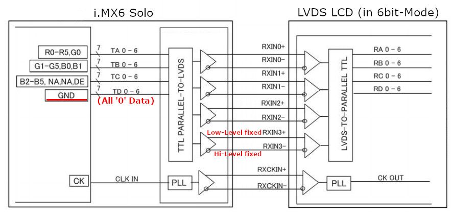

Hi All,
Tell me how to control the LVDS port output.
We try to use a specific LVDS-LCD with i.MX6-Solo.
When the LCD is in 6-bit mode, according to the LCD spec, the RXIN3 +/- input level should be fixed.
What settings should I make for i.MX6?
How should I change the DeviceTree and Driver-Code?
George.

Hi George
for such mode one can use ldb dts settings
fsl,data-mapping = "spwg";
fsl,data-width = <18>;
as in example below (&ldb {...)
https://source.codeaurora.org/external/imx/linux-imx/tree/arch/arm/boot/dts/imx6qdl-sabresd.dtsi?h=l...
adjust lcd timings as in example below
https://community.nxp.com/t5/i-MX-Processors/How-to-change-SABRE-SD-screen-resolution-in-LOLLIPOP-5-...
igor

Dear Igor,
wonderful!
Thank you for the clear answer.
BR,
George
